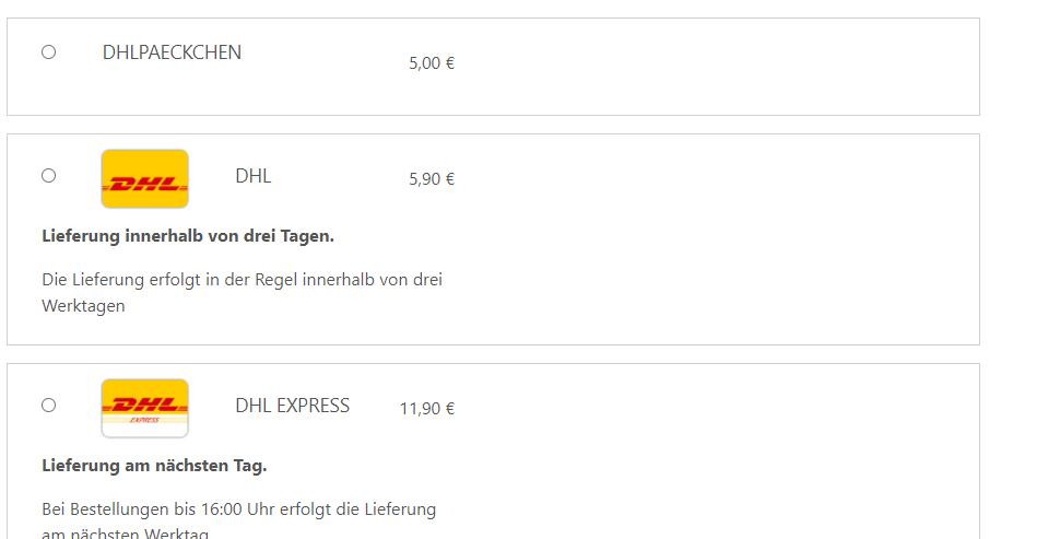

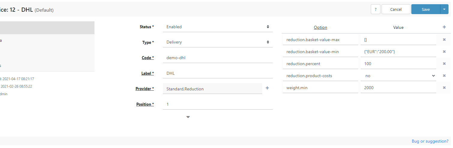

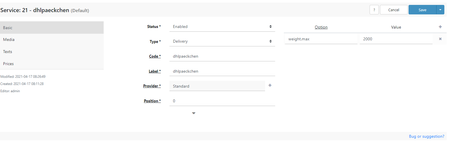

Oh, yes all i did so i think. see the pictures but that i do with download.all nothing happens, and that i did with max and min-weight, nothing happens in frontend and with reduction 100 percent too i think. I used the demo-article for to do in basket, it have already weight. I hope i have an fail in, please tell me :).

For using the Weight decorator you have to add the Weight decorator to the provider field. Otherwise, you have configuration that isn't used.
