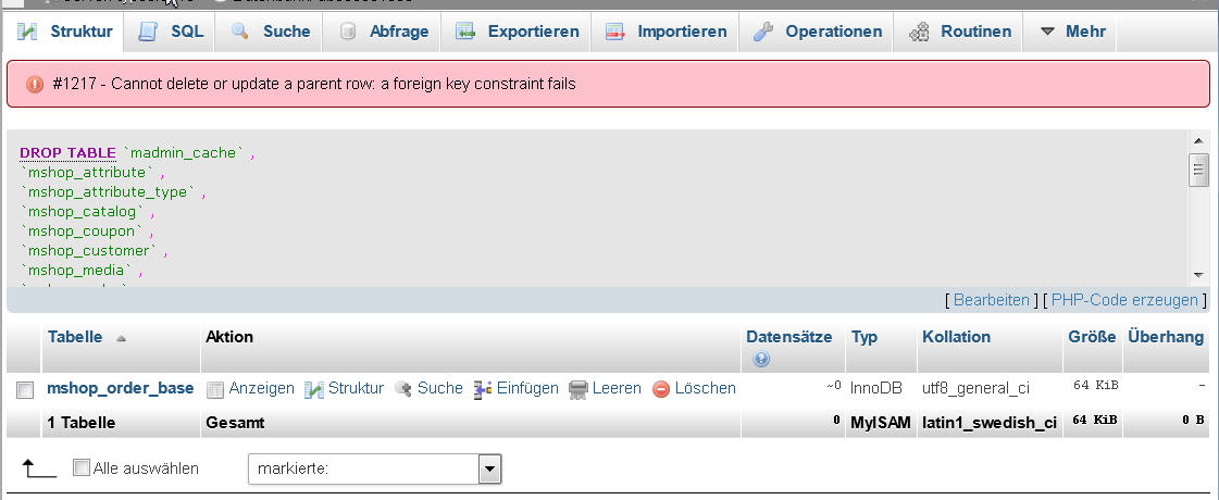

By the way, when I tried to empty the database I´ve got a message which might be of interest for some debug matters:
#1217 - Cannot delete or update a parent row: a foreign key constraint fails
I made this screenshot:

Tomas wrote: #1217 - Cannot delete or update a parent row: a foreign key constraint fails
That's normal. The tables contain constraints to each other so they must be dropped in a specific order - or you drop all and redo this until all tables are deleted.
