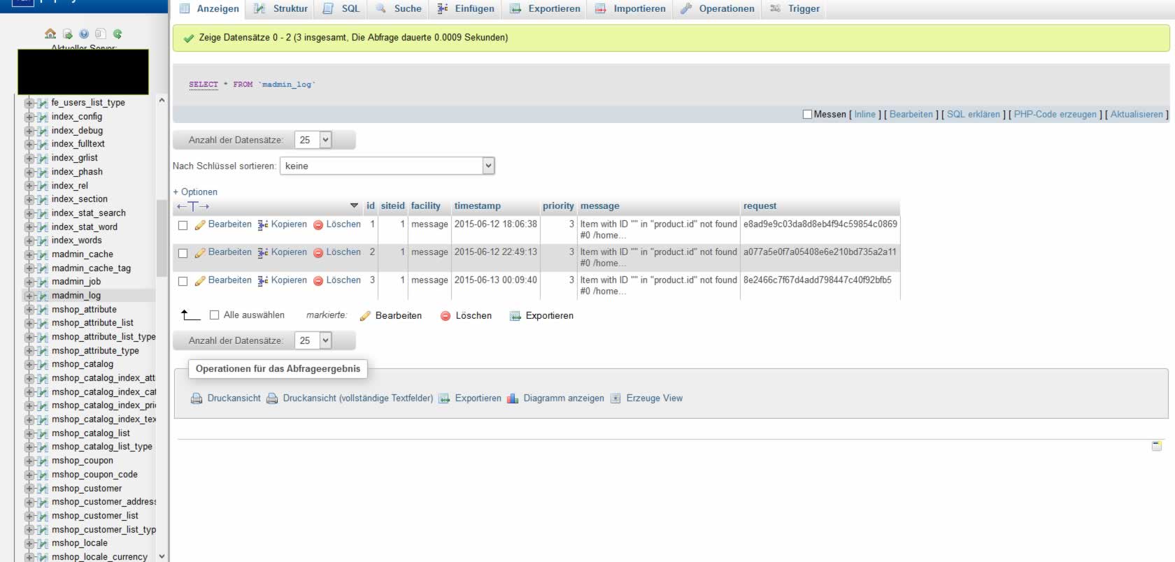

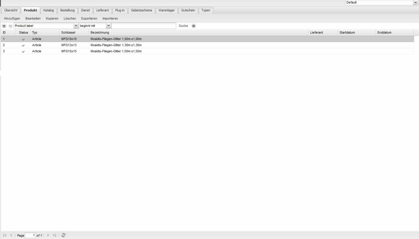

I have found "Item with ID "" in "product.id" not found" in the madmin_log, but the producty have IDs?!
Any ideas?

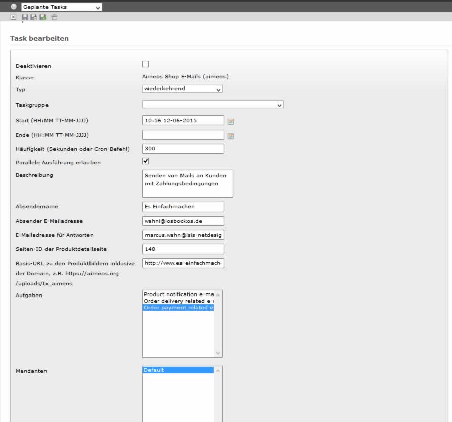

Post by WahnM » 19 Jun 2015, 12:48
Here is the task. Anything wrong?
