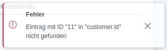

After the upgrade some customers are missing.
I can click on every order and then "show customer" (the eye symbol).
After that I get an error that the customer is not found.

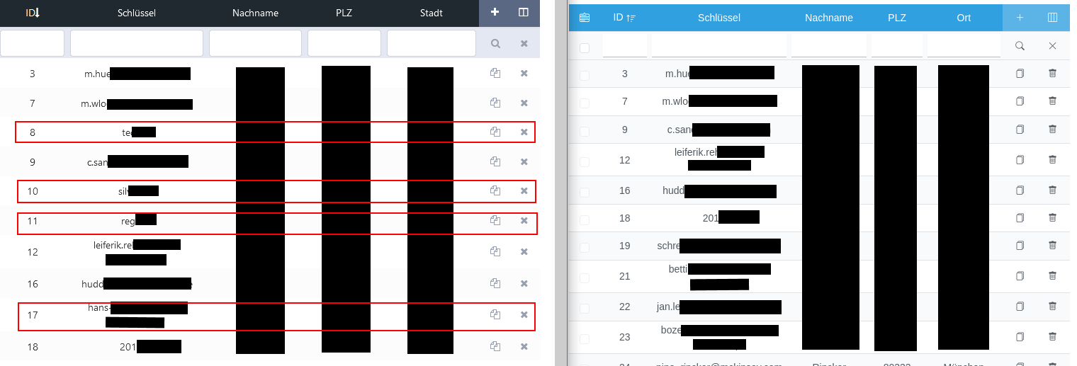

I compared the old customer list (v18.10.11) with the new one (22.7.3-pre3) and can confirm that.

For example customer with ID 11 is available in both versions (as Frontend User), but are missing in the customer list of v22.7.x

Post by Moritz » 16 Sep 2022, 10:43
I can't recognice any differences between the fe_users tables, because you see the same table on both pictures.
Left is my VM with Typo3 v9 and Aimeos 18.10.11 and right is my VM with Typo3 v11 and Aimeos 22.7.3-pre after running the upgrade wizard.
I recogniced that mostly customers not found which have already ordered something.
