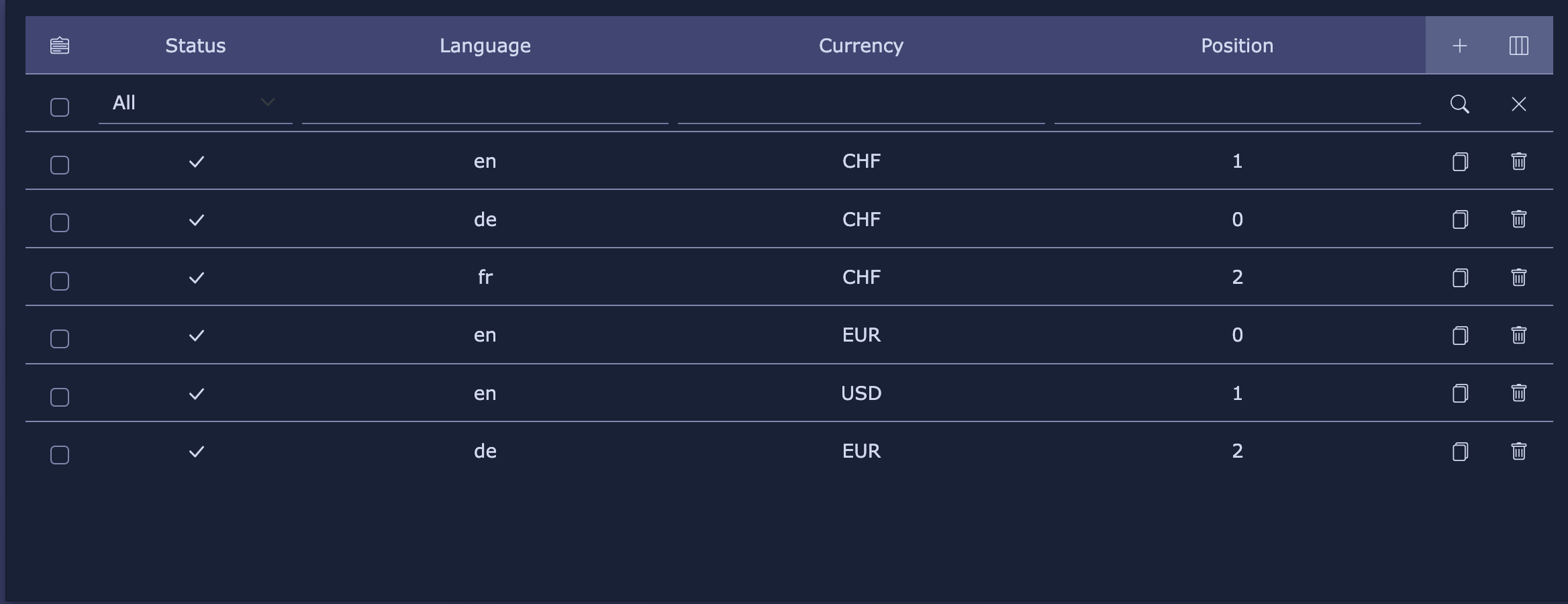

TYPO3 12 and Aimeos 24 composer installed:
Translation no longer works.
Unfortunately I could not find out where the problem is.

Can you check the Locale > Locale panel in the admin backend, which language/currency combination is at the first position?
Bildschirmfoto 2024-10-17 um 21.26.21.png (103.33 KiB) Viewed 42959 times

Are the last three entries added by you or are they from the demo data of the setup tasks?
In the later case, what happens if you remove the last three entries?
