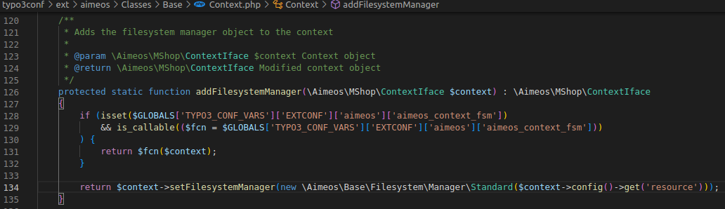

The configuration in the EXT:aimeos/Resources/Private/Config/ folder doesn't seem to get loaded so there's no array returned for the "resource" key or it's overwritten by TypoScript somewhere. Can you please check here what happens:
- https://github.com/aimeos/aimeos-typo3/ ... hp#L32-L37

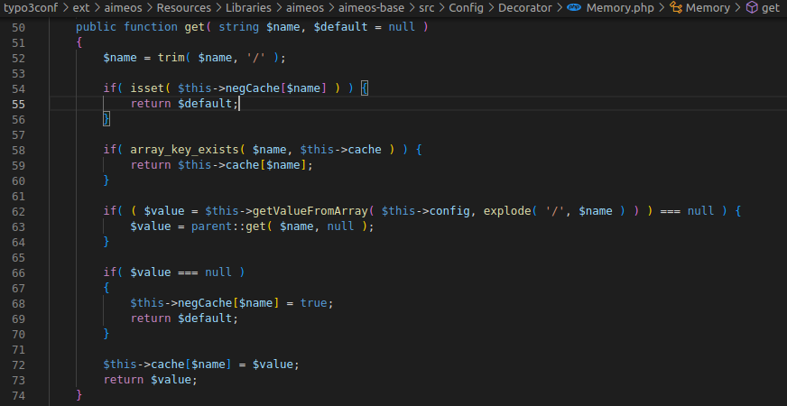

I don't know what I can check here.
How do you say, the resource config is not loaded.
$context->config()->get('resource') returns NULL
Because it is not in the $this->negCache

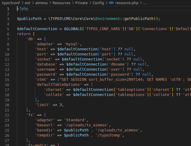

This is the same error as before and corresponds to your missing resource configuration (whatever is the reason for that). Did you check if the EXT:aimeos/Resources/Private/Config/resource.php file is there and you didn't overwrite parts of the configuration?

Post by Moritz » 15 Nov 2022, 07:35

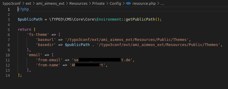

The file EXT:aimeos/Resources/Private/Config/resource.php exists and of cource I changed nothing in this file.
In my extension I override some settings.

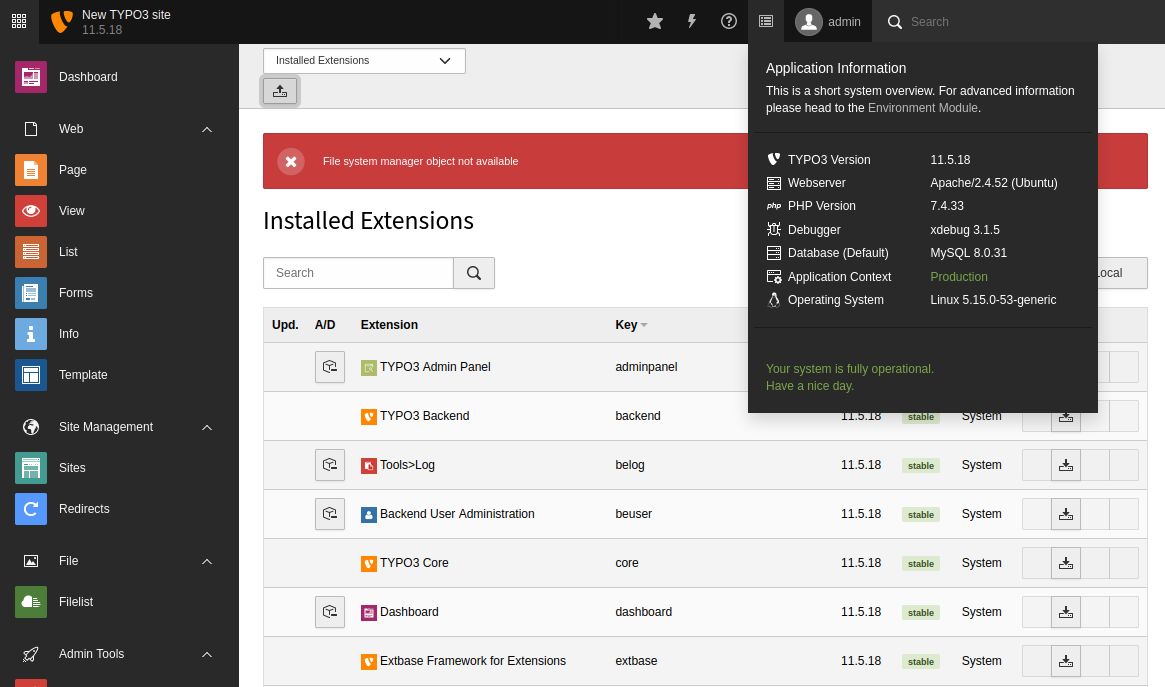

Post by Moritz » 15 Nov 2022, 09:23
Moritz wrote: 11 Nov 2022, 11:54 When I go to Admin Tools -> Upgrade -> Check TCA I get the following exception.
I have installed Aimeos 22.10.1 in a fresh Typo3 v11.5.18 environment and get the same error.

Post by Moritz » 16 Nov 2022, 10:49
In a complete fresh Typo3 v11.5.18 environment i get this error when installing Aimeos v22.10.2
