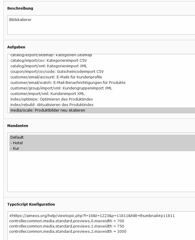

Re: Thumbnail too big
I haven't success with this. Cleared all the caches but this isn't working for me.
Is the thumbnail in the basket generated this way as well?
- scheduler.JPG (75.49 KiB) Viewed 107705 times
The configuration options have been shortened in Aimeos 2021.x, so the "standard" part has been removed:
controller.common.media.previews.0.maxwidth = 700
