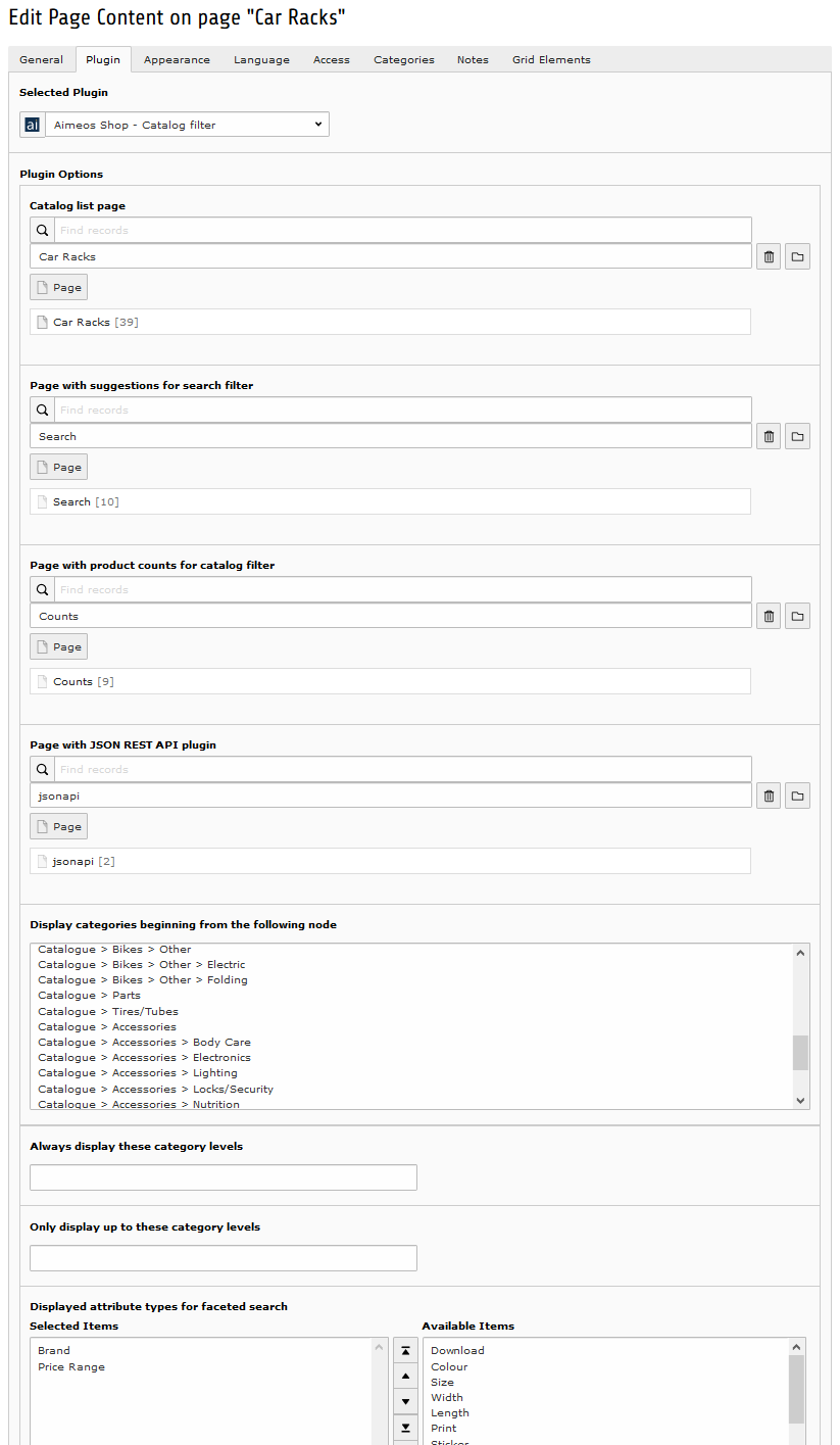

Ah OK. I did have both a catalog filter CE and a Catalog Attributes CE (to create separate "Categories" and "Filter" headings on the frontend ... or so I thought), and the catalog filter had the "Display categories beginning from the following node" set to Car Racks.
I have now hidden the Catalog Attributes CE and put everything into the Catalog Filter CE (keeping the Car Racks default category in the plugin tab/settings). Upon doing so, nothing changes - looks exactly the same as the screenshot previously sent. So, I set "Display categories ... " to nothing, annnnd now it's worse, showing the entire Catalog in the Categories filter.

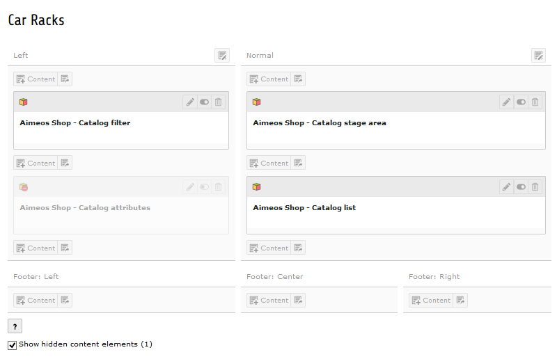

Re: Attributes Filter Shows All Attributes Even in a SubCategory
Yes, that's what I did (i.e. removed the attribute filter) ... but it still doesn't work! See attached ...
-S
-S
The catalog filter component contains search, categories and attribute filter. You should use the catalog tree plugin instead if you only want to show the categories.
