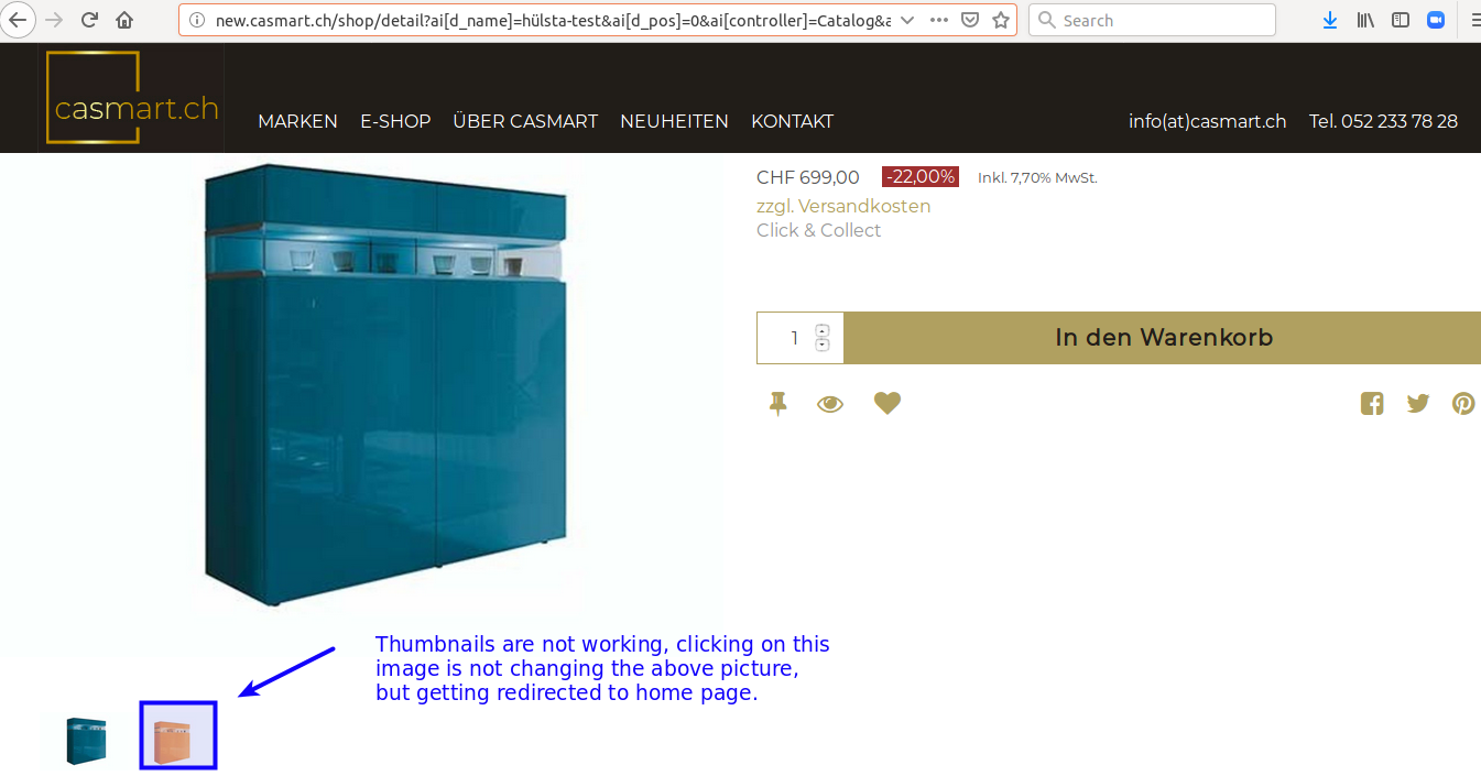

We are facing a issue in the product details page. We uploaded 2 images against a product. But, in the product details page, the thumbnails are not working. The 2nd image is not displayed on clicking the corresponding thumbnail. Instead, we are redirected to the home page.
We noticed that full URL is not generated to these thumbnail links.

- prd_details.png (193.08 KiB) Viewed 2610 times
Re: Thumbnail image links not working, redirecting to home page.
Seems like you didn't configure the catalog detail plugin correctly because TYPO3 doesn't generate URLs for that page
