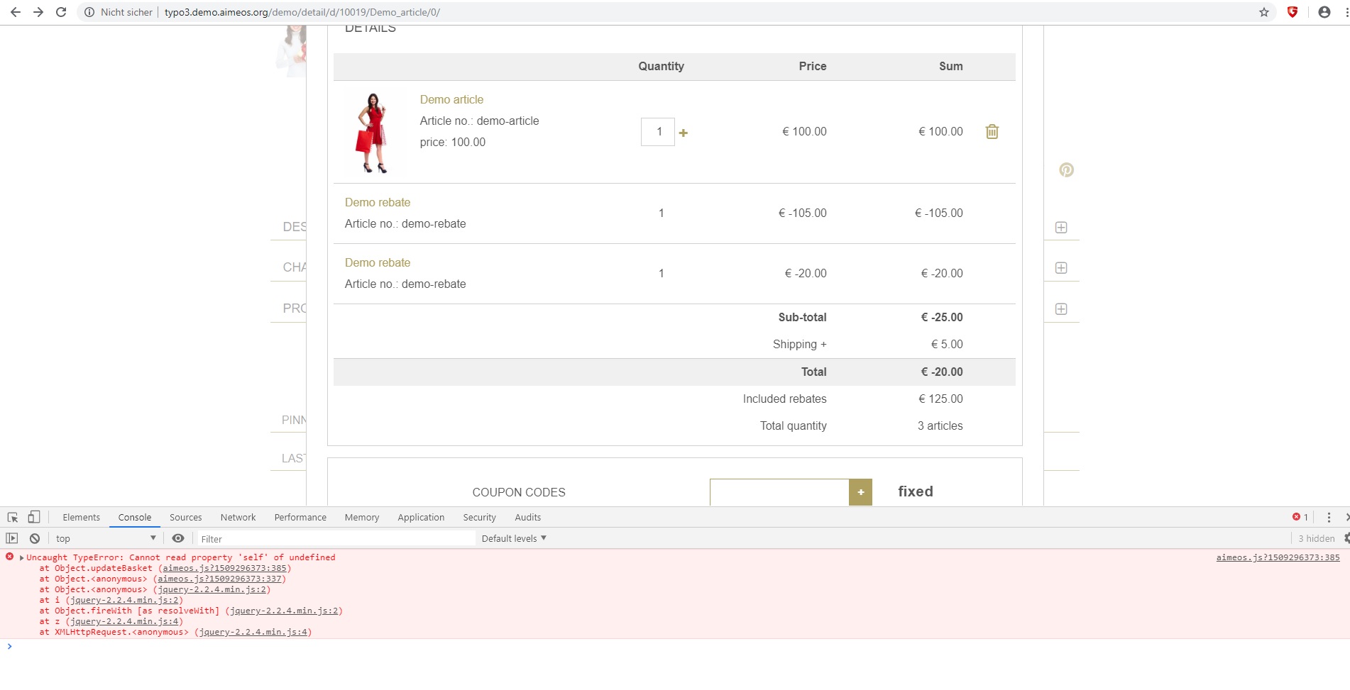

i am playing with the aimeos jsonapi and run into an error i couldn't fix.
My first attempt was that it has to do with my own extension, but after awhile of frustrating debugging and digging deeper into the code, i tried it on the aimeos demo site and saw that the error also exist there.
How i ran into the js error.
1. Open http://typo3.demo.aimeos.org/demo/detai ... article/0/
2. (Put the demo article into Basket) - Press Button "Add to Basket"
3. (Basket opens, with the demo Article attached)
4. (Add the coupon fixed) - Type "fixed" into coupon field

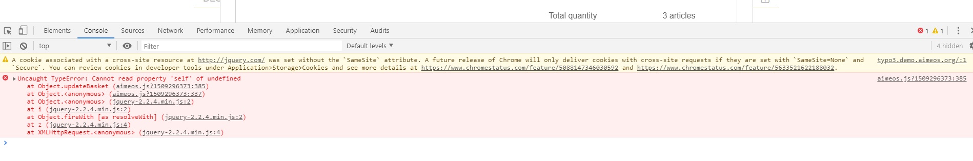

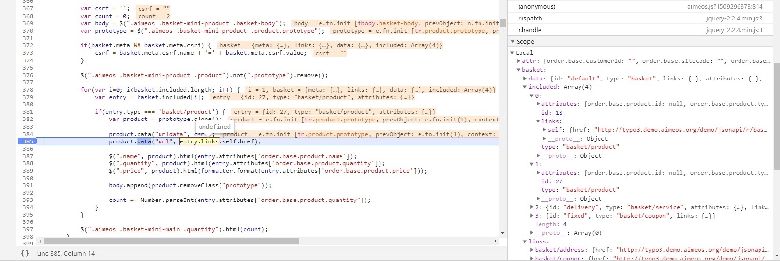

The error Occurs in the aimeos.js File at the updateBasket function on the second element of basket.included at line 385 when it tries to set the entry.links.self.href.
Entry.links is at the second element of basket.included undefined and therfore you will get bellow JS Error in Browser console. (See Pics Error-1 to Error-3)
aimeos.js?1509296373:385 Uncaught TypeError: Cannot read property 'self' of undefined
at Object.updateBasket (aimeos.js?1509296373:385)
at Object.<anonymous> (aimeos.js?1509296373:337)
at Object.<anonymous> (jquery-2.2.4.min.js:2)
at i (jquery-2.2.4.min.js:2)
at Object.fireWith [as resolveWith] (jquery-2.2.4.min.js:2)
at z (jquery-2.2.4.min.js:4)
at XMLHttpRequest.<anonymous> (jquery-2.2.4.min.js:4)
- Error-1.jpg (247.26 KiB) Viewed 8813 times
- Error-2.jpg (110.95 KiB) Viewed 8813 times
- Error-3.jpg (114.23 KiB) Viewed 8813 times

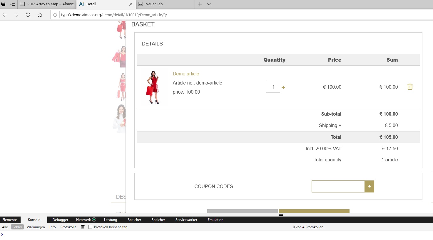

Pic Step 2 and Step 4
- Step 2) Demo Article in Basket.jpg (118.86 KiB) Viewed 8812 times
- Step 4) Adding coupon fixed.jpg (170.54 KiB) Viewed 8812 times

No, the JSON:API response is correct at that place. It must be
But I think that is the wrong place you are looking for the problem because "entry.links" is already undefined. This is because it's a rebate product you can't change in the basket and therefore, the "links" section is missing:
https://github.com/aimeos/ai-client-jso ... d.php#L109
The the problem is a missing check in Javascript if "entry.links" exists because this isn't always the case.
Can you test that and create PR with a fix?
"basket/product": {
"href": "<?= $this->url( $target, $cntl, $action, ['resource' => 'basket', 'id' => $basketId, 'related' => 'product'], [], $config ); ?>",
"allow": ["POST"]
Re: JS Error in Aimeos Lib
A quick and dirty sollution would be this.
product.data("urldata", csrf);
if( typeof entry.links !== "undefined"){
product.data("url", entry.links.self.href);
//product.data("url", entry.links.self.href);
Seems to be a good solution too
