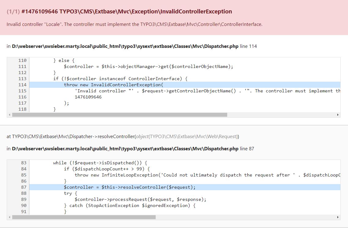

Hi folks
I installed the aimeos extension 20.7.2 on my TYPO3 10.4.6 (PHP 7.2). Like described in the external manual, I imported the page tree with the T3D-File. If I would like to view the start page, I get the following error message
Does anybody know, why this error occurs?
Thx in advance
Marcel
Re: Invalid controller "Locale". The controller must implement the TYPO3\CMS\Extbase\Mvc\Controller\ControllerInterface.
Post by aimeos » 08 Sep 2020, 15:03
We haven't seen that error before and TYPO3 10.4.6 works without problems in our environment.
Which .t3d file did you import?
Post by aimeos » 11 Sep 2020, 10:05
Does this error also occur if you remove/disable the "Locale selector" plugin from the page in the TYPO3 admin backend?
Post by hweckhardt » 19 Sep 2020, 18:10
Has theen problem been solved? I am interested in the solution, as I get the same error message (Typo3 10.4.8 and aimeos shop extension 20.7.3.
Post by hweckhardt » 21 Sep 2020, 07:32
I would like to re-open this issue.
I can open the shop page now, but the "Locale select" plugin in the right column of this page (and all others with this plugin) the same error appears. I am using Typo3 10.4.8 and bootstrap_package 11.0.2.
Many thanks in advance for your help.
Post by aimeos » 22 Sep 2020, 07:48
Does it work if you add this line:
implements \TYPO3\CMS\Extbase\Mvc\Controller\ControllerInterface
after this one:
https://github.com/aimeos/aimeos-typo3/ ... er.php#L22
Maybe you have to clear all caches and delete the ./typo3temp/ directory until the change is used.
Post by hweckhardt » 22 Sep 2020, 09:35
Many thanks for your fast answer.
I do not see a difference to the line 22 in the file Classes/Controller/AbstractController.php which is delivered with version 20.7.3.
Best regards,
Horst-Walter Eckhardt
Post by aimeos » 22 Sep 2020, 09:48
The current lines are:
abstract class AbstractController
	extends \TYPO3\CMS\Extbase\Mvc\Controller\ActionController
Can you try using:
