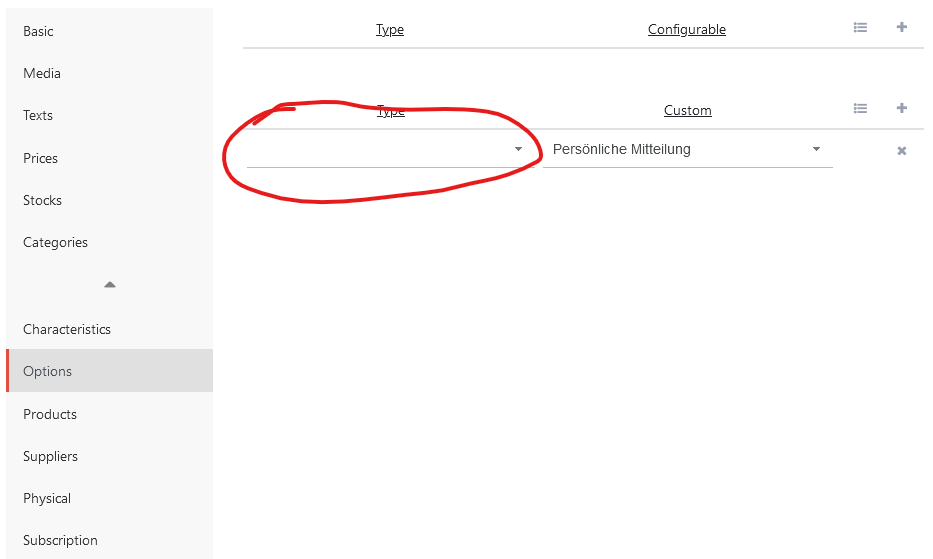

Post by promptnet » 23 Nov 2020, 16:33
logged in with a user with limited rights (editor), I cannot add options in "Product" > "Options". It is possible to select a value in "Configurable" or "Custom" section, but it is not possible to select something under "Type". And, if I write "text" in "Type" the value disappears on blur.
What configuration do I have to set to change that behaviour?
Cheers, Kurt

Re: Not allowed to add option under "Products/Options"
Post by aimeos » 25 Nov 2020, 12:17
The problem was that editors were not allowed to use the JSON admin API endpoint for fetching the attribute types. This is fixed now using this commit:
https://github.com/aimeos/ai-admin-json ... 695ce1ecb4
You can install the bugfix using:
composer req aimeos/ai-admin-jsonadm:2020.10.x-dev
You can also change the configuration yourself for the backend. In that case, only the groups for "attribute/type" are relevant.
Post by promptnet » 25 Nov 2020, 19:55
Many thanks!
I did it the other way round: instead of having the group "editor" I assigned a group with name "super". Now it works perfectly.
