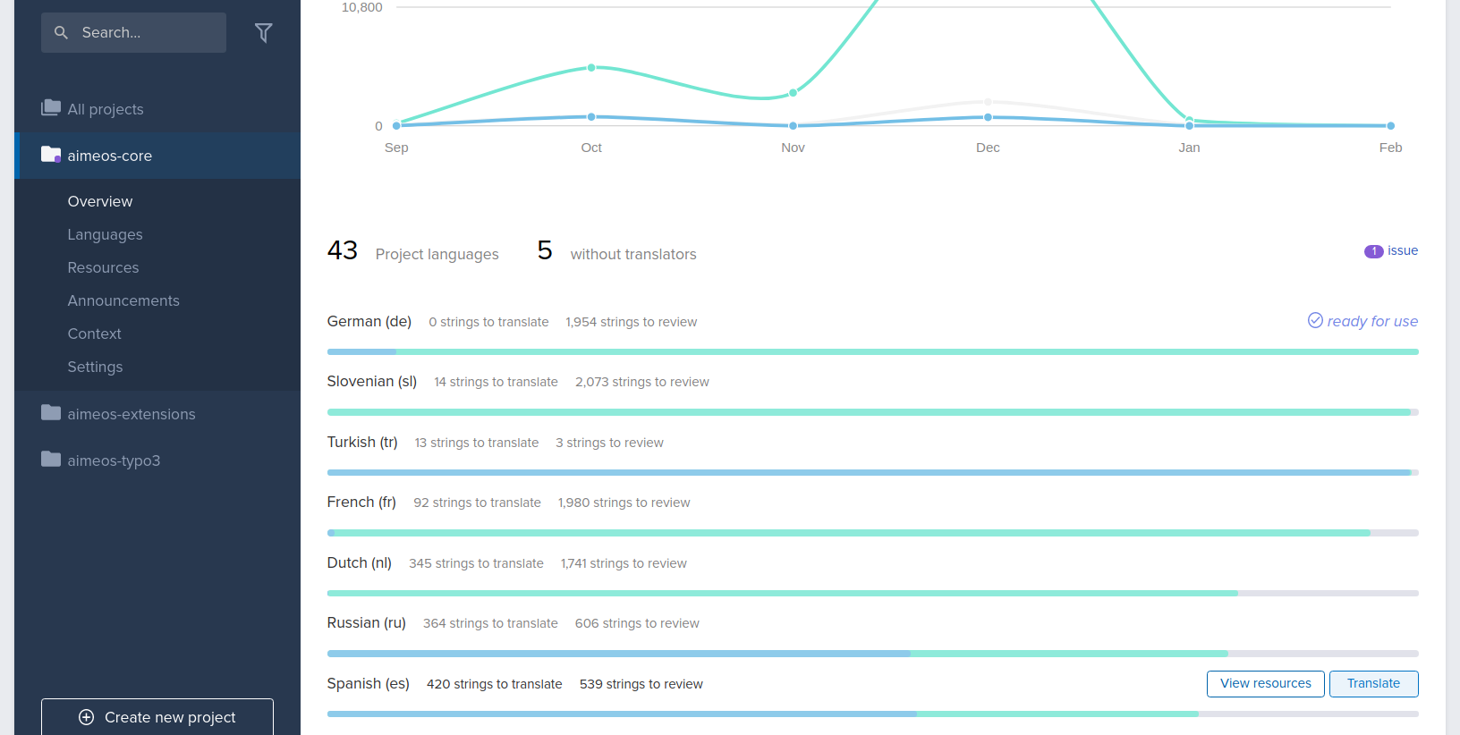

Choose your language in the list when you are in the Aimeos project:
From there, you can select the resource and start translating.
The Transifex account for translators isn't time limited, only if you want to create your own project which isn't Open Source.
