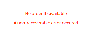

After the Payment is successfull processed with the external payment provider and then it returns to the aimeos shop page I get the following error:
Error after Return from external Payment Provider

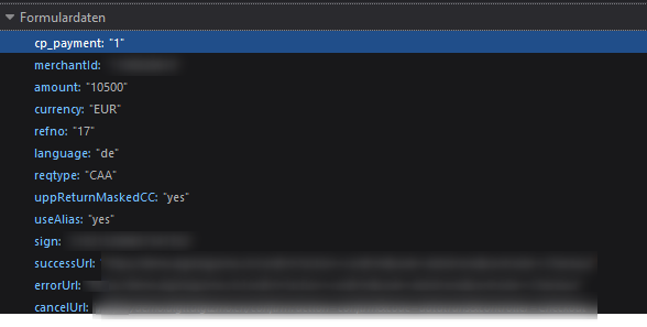

Here are the POST Request by the aimeos Shop with the Demo Credentials:
POST Request to Payment Provider

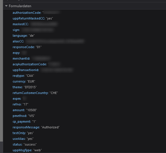

And here the POST Request from the Payment Provider to the Aimeos Shop:
POST REquest From Payment Provider

Does Aimeos need more information in the POST Request or why does it no find the order after the successful payment?
Re: Twint as a Payment Option
Post by aimeos » 20 Feb 2021, 09:02
We've seen that problem before with Datatrans and TYPO3. Since Google Chrome implements the SameSite policy for cookies, it won't send the FE session cookie to your website any more after Datatrans redirects back to your shop. Here's a workaround:
