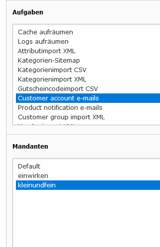

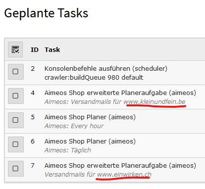

I think I found a bug when having multiple mandates and a cron job for each of them for customer account emails.
Now, if anybody makes an order in shop 1 (kleinundfein) he gets an email from shop two (einwirken), even if there are two cronjobs, and only one site assigned in the cron job (s. attachments).
He now gets an email with correct user credentials but with wrong URL (from shop 2) to login.

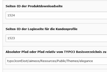

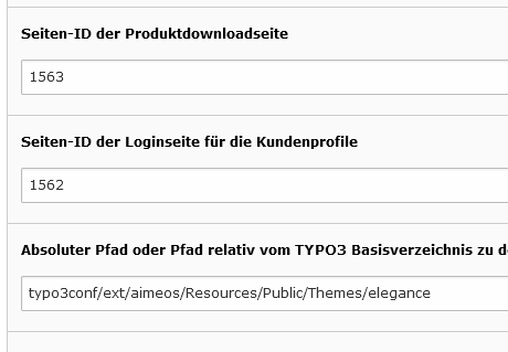

Do you also use different page IDs in the field for the login PID of the two Aimeos advanced scheduler task?

Post by promptnet » 01 Feb 2021, 10:30
Yes, I do. But to be sure that I understand you correctly, I attach the two different screenshots from the scheduler.
