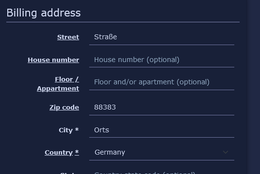

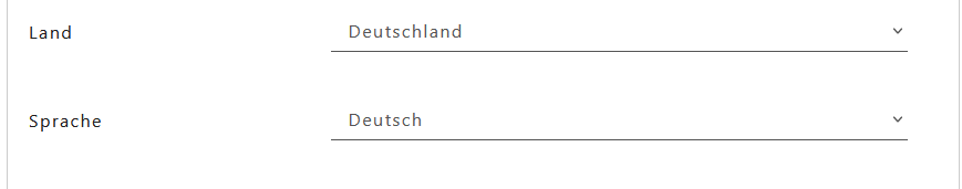

I have if i want to save in orders an order with changes following:
But in the account from user in frontend are germany setted, in customers in aimeos backend too. not in users from typo3.
ANd following error if i want to save :
its btw no country choosable where i want to save...
Im right that static_info_tables not needed anymore in the curretn version?
same at delivery and billing adress:

only in the choosement from the first two pics in billing and deliveryadress. but only in the orders panle. not in the customers. there are the delivery and billing adress germany used, normal
Re: 21.7.1 Problems
Post by aimeos » 23 Jul 2021, 10:03
The country ID in the order panel has already been fixed but the fix isn't part of 2.7.1 from TER. It will be part of the next minor release.

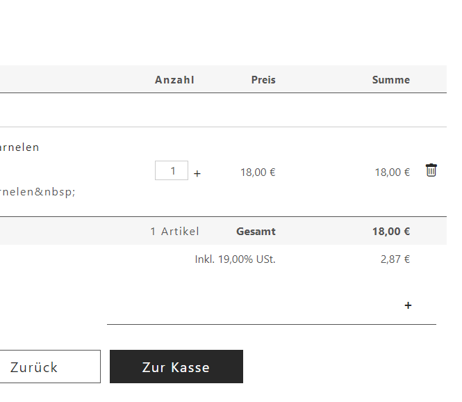

Shopmister wrote: 27 Jul 2021, 07:54 3) The basket if clicking "add to basket" (see picture)
- if i delete from these two things:
- it redirect me to the basketpage. wich not happen with small basket.
This is as implemented.
Shopmister wrote: 27 Jul 2021, 07:54 - the small basket dont change the number of items in it.
Tested and works in a new distribution setup. As the number of items is updated by JS, there seems to be an old version or another problem in your setup.
