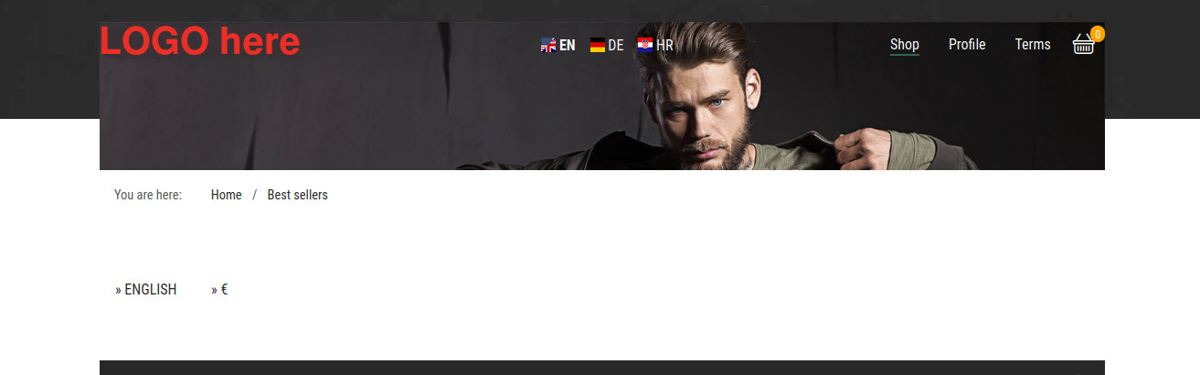

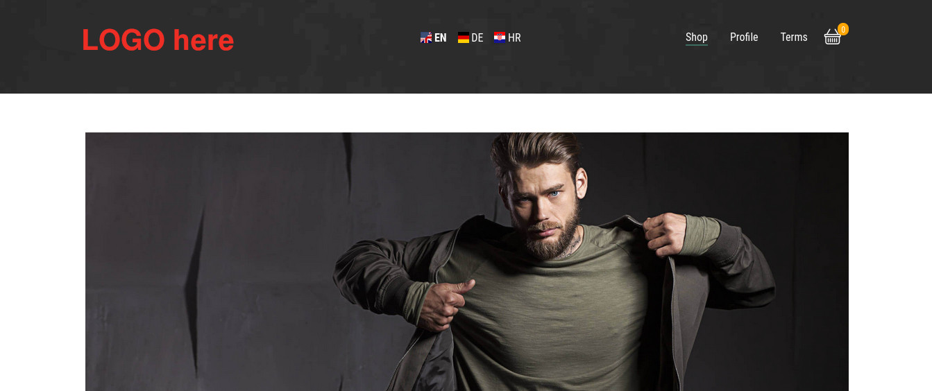

However something is wrong now in the CSS for: .aimeos .catalog-stage-image
The image is placed wrong and does not have a height set to auto.
(Again a bit difficult to say without an example, my reference is a fresh distribution install).
- Before CSS changes
- Before CSS change.jpg (87.78 KiB) Viewed 23265 times
- After CSS changes
- After CSS change.jpg (53.91 KiB) Viewed 23265 times

The result: (logo erased in the jpg)
Is it possible to post an example of what we should see?
- Screenshot from 2021-07-27 14-21-30.jpg (46.78 KiB) Viewed 23258 times
Re: Again v21.7 - [Solved in 21.4] - zeynepjs mobile-first navigation menu
This is exactly how it should be.
Hmmm, in that case: was the image meant to be hidden on mobile?
Now only a silly small stripe is left.
This is how the new theme should look like:
https://themes.demo.aimeos.org/
