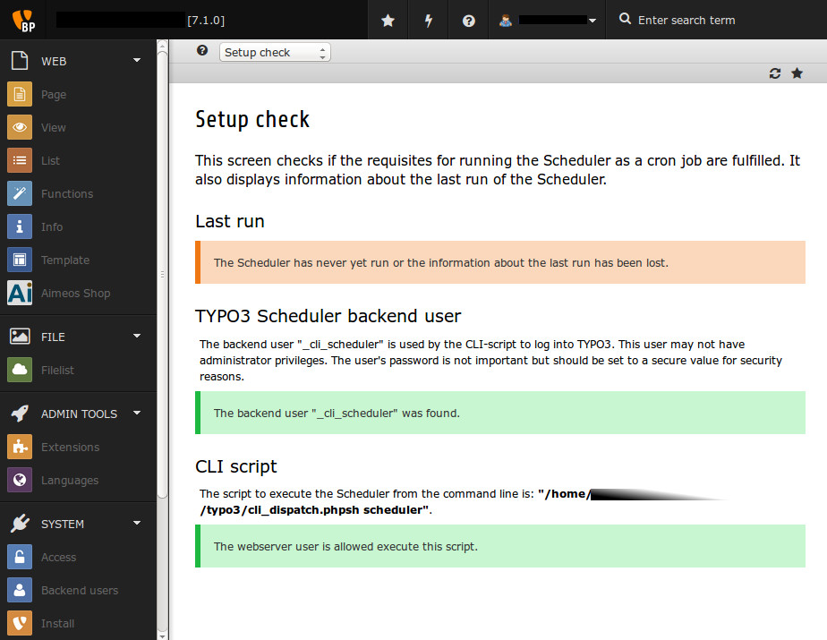

Re: Scheduler dont do the jobs
yes via cronjob, every minute
yes i run the Setup check, except the first column (Last run) is all green
thanks,
Mario
thanks,
Mario

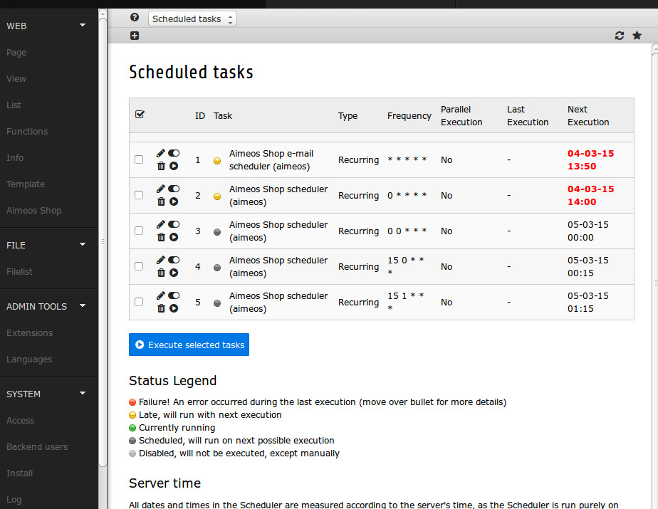

Hi Mario
Can you attach a screenshot of your scheduler task list and of one task details that doesn't work?
BTW: What exactly doesn't work? Can you describe in more detail what you are expecting?

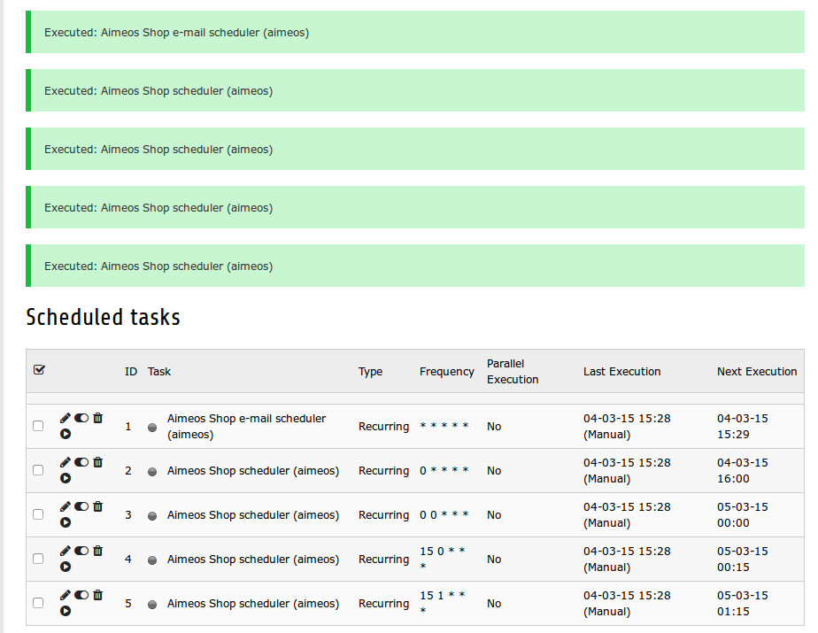

Hi aimeos,
if i do the jobs manually, all works fine, but the typo3/cli_dispatch.phpsh is not fired by the scheduler.php which is targeted from cronjob.
thanks
thanks
- manually executed
- scheduler3.jpg (133.92 KiB) Viewed 42964 times
- scheduler1.jpg (148.8 KiB) Viewed 42964 times
- after fresh installation typo3 and aimeos_dist with running cronjob and configured tasks like described in Manual
- scheduler.jpg (142.88 KiB) Viewed 42964 times
