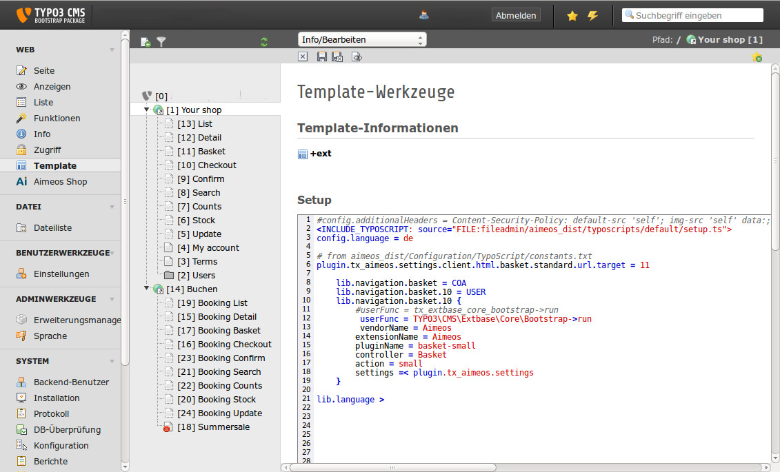

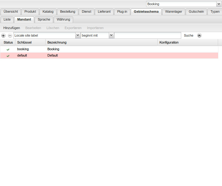

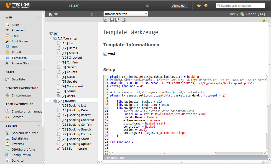

In the Aimeos Documentations are described how to setup more than one Shop.
Do i need a further Extension to manage a second shop like described here?
http://aimeos.org/docs/User_Manual/Admi ... with_sites
http://aimeos.org/docs/TYPO3/Configure_multiple_shops
Thank you!
Or what should i do? because something is going wrong if i try like described.Furthermore, the we also offer an extension which enables you to add sub-shops that inherit products, categories, pictures, texts, etc. from a parent instance and you can even add more sites to these sub-shops without any restrictions in depth. This is perfect for market places or resellers.
Thank you!

No that's not necessary if your shops are independent.alpin3rocker wrote: In the Aimeos Documentations are described how to setup more than one Shop.
The setup of an additional shop is a little bit tricky. Could you please try the following:alpin3rocker wrote: Or what should i do? because something is going wrong if i try like described.
* Rename your "default" site code to something else
* Go to the extension manager and click on the update button of the Aimeos web shop extension so it creates a new "default" site with all required database entries
* Now you can rename your new site code and the "default" site code again to their final names
* Your TS setup is OK as far as I can see but you also need to set the site code in the PageTS config as well (http://aimeos.org/docs/TYPO3/Configure_multiple_shops)
If it works for you too I will update the documentation.

i renamed it in "pending"* Rename your "default" site code to something else
i did this and get a third new "default" shop/site at the locale section in the Manager* Go to the extension manager and click on the update button of the Aimeos web shop extension so it creates a new "default" site with all required database entries
i renamed the new third shop from "default" to "test" and the "pending" back to "default"* Now you can rename your new site code and the "default" site code again to their final names
Yes that was made.* Your TS setup is OK as far as I can see but you also need to set the site code in the PageTS config as well (http://aimeos.org/docs/TYPO3/Configure_multiple_shops)
It doesn't work. Something is still going wrong.If it works for you too I will update the documentation.
