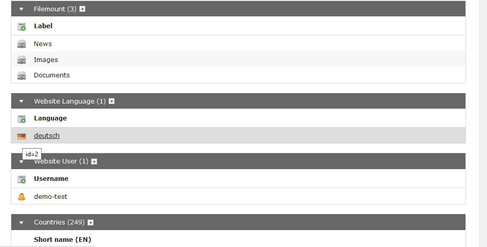

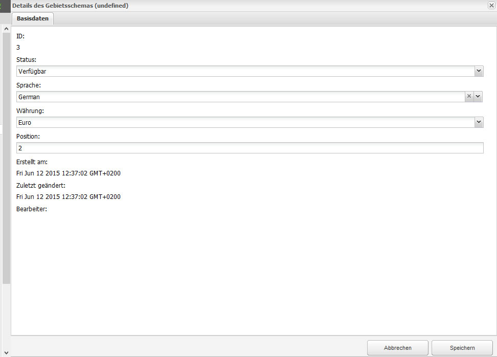

Thanks for reply.
Hm. Enclosed you find my language setting in the root page an the local configuration of the aimeos shop. I will take a look at the table und reply as soon as psossible.
Bye

No. I didn't. IS it possible to set a valid entry?aimeos wrote:Did you overwrite translations using the TS config field in the scheduler task?
The error occurs if the content of $message is an array instead of a string which is most likely caused by an invalid translation entry.
I've now tried to send messages manually after deleting the country code in the root page. But same problem. Now I will take a look at the corresponding table.
CU
Marcus

Do you have only one entry in the locale tab of the admin interface with language "de" and currency "EUR" or are there more?
Re: Problem with sending scheduled e-mails
Only one. de with euro.
