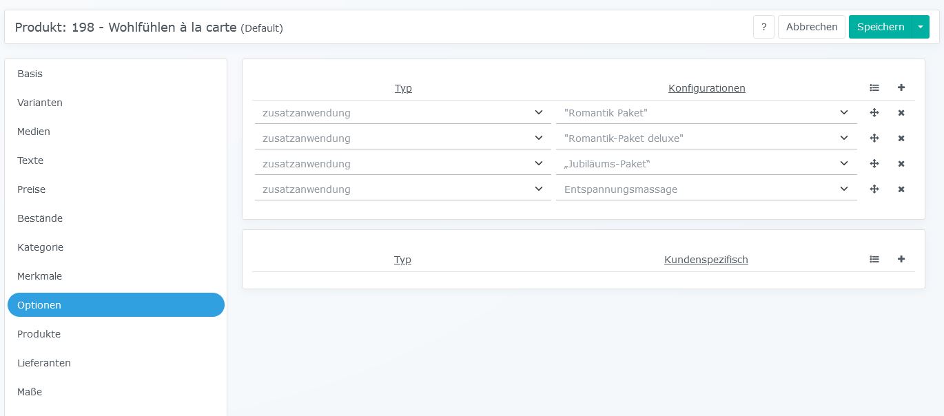

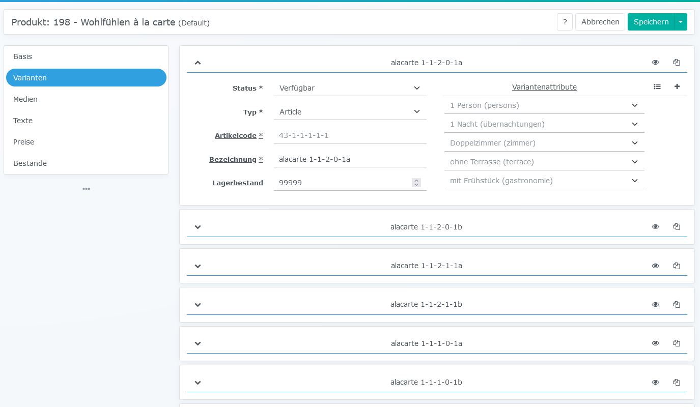

I've a product with a few variants and on the main product i added options.
When I configure my product I'm not able to submit it. The product without the additional options works fine.

Can you post a few screenshots from the admin backend where we can see the product variants and configured options?

Post by billy678 » 07 Jun 2022, 11:35
Sure.

The attribute in the options is declared as an input. If I run it as a normal select it work for me too, but I need it as an input.
plugin.tx_aimeos.settings.client.html.catalog.attribute.type.zusatzanwendung = input
