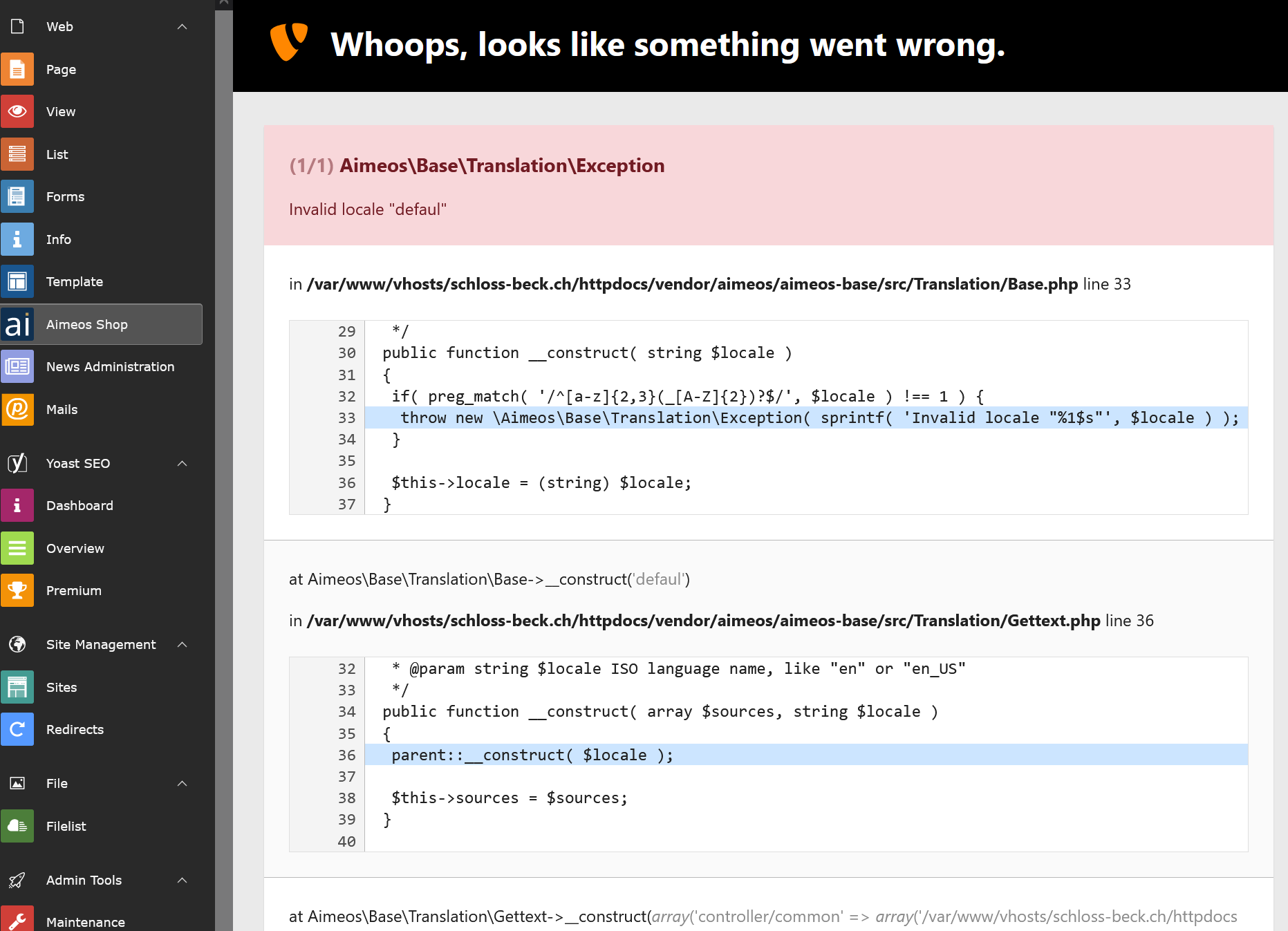

after the installation setup (composer), in backend I get the error message 'Invalid locale "defaul" '
Why ? And how to fix that ?
All other functions (except Aimeos) work correctly.
Thanks,
Aimeos: 22.4.3
TYPO3: 11.5.12
PHP: 7.4.30
Linux
Thanks,
Aimeos: 22.4.3
TYPO3: 11.5.12
PHP: 7.4.30
Linux
- Error message
- aimeos-invalid-locale.png (183.06 KiB) Viewed 11154 times

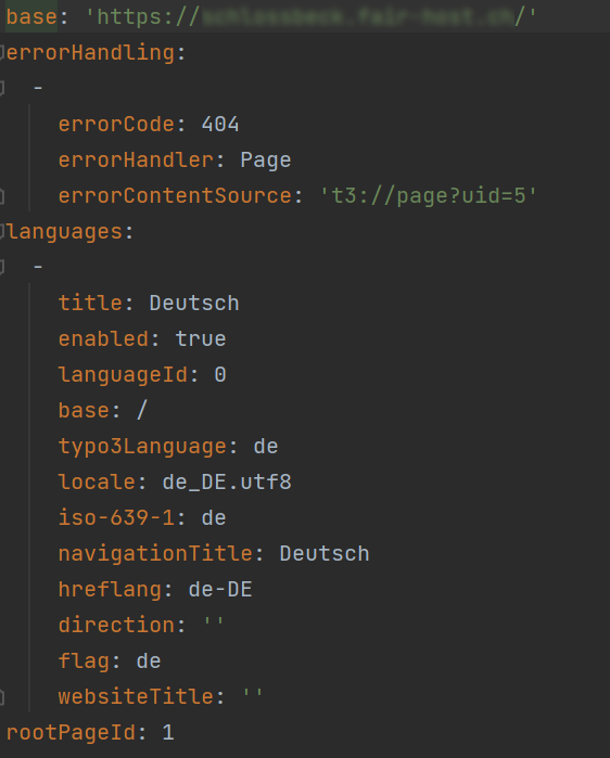

"defaul" is very strange, TYPO3 11 uses "default" if no language is explicitly set.
Can you check your site configuration for the used language?
Re: Error message Invalid locale "defaul" after installation
Yes, it is very strange. This is the configuration (s. image)
- site-configuration.png (52.32 KiB) Viewed 11129 times

Can you post the complete stack trace, please?
The "defaul" value seems to appear somewhere here:
https://github.com/aimeos/aimeos-typo3/ ... #L112-L116
Can you check what this contains?
$GLOBALS['BE_USER']->uc['lang']Professional support and custom implementation are available at Aimeos.com
Thank you very much!
The language of the backend user was set to "defaul" instead of to "default". I don't know how this could happen. Probably during the upgrade of TYPO3.
