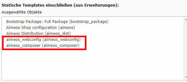

Hi Aimeos-Team!
I have two Typo3-Ext (2022, composer/webconfig) with same template for overwriting the original aimeos ():
( .. aimeos_(composer/webconfig)\Resources\Private\Extensions\aimeos_ext(composer/webconfig)\templates\client\html\catalog\detail\body.php) for overwriting but the "first is winning".
I assumed that the ordering in the static template is responsible for the overwriting but it seems that the naming is responsible for that behaviour. aimeos_webconfig is always "winning", if i uninstall then aimeos_composer kicks in.
Is this a bug or cannot we overwriting templates from other custom aimeos-ext.?
- screenshot-aimeos.local-2022.07.04-14_31_06.png (14.56 KiB) Viewed 7426 times

If you have installed two custom Aimeos TYPO3 extensions, they are sorted by name because the used keys in ext_localconf.php are:
See here for the code in the Aimeos TYPO3 extension:
https://github.com/aimeos/aimeos-typo3/ ... hp#L19-L20
You can change the order of your extensions if you rename "1_aimeos_composer" to "2_aimeos_composer" in typo3conf/ext/aimeos_composer/ext_localconf.php
0_aimeos // Aimeos extension
1_aimeos_composer // own Aimeos extension
1_aimeos_webconfig // own Aimeos extension
Re: overwrite template: more than one extension
This does not work for me. I changed the keys as your described but same effect, aimeos_webconfig is used.
Strange:
I uses 10_ and 20_ as key, but Configuration->Extconf looks
The static template config has no effect. If I remove a aimeos-own-extension, the template is still used.
I have to uninstall the extension.
Strange:
extDirs
0_aimeos = EXT:aimeos/Resources/Private/Extensions/
1_aimeos_webconfig = EXT:aimeos_webconfig/Resources/Private/Extensions/
2_aimeos_composer = EXT:aimeos_composer/Resources/Private/Extensions/I have to uninstall the extension.
Remember that the ext_localconf.php file is cached by TYPO3. You have to remove and add the extension again in the extension manager to see any effect of your changes.
