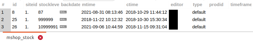

I tried the upgrade wizard with the new version 22.7.2 and get errors for table mshop_stock.
Before the upgrade the table looks like this.

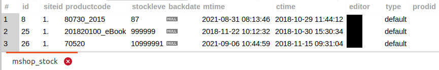

I executed the wizard and get this error.
The table after this.

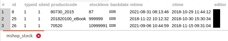

I executed the wizard again and get this error.

Post by aimeos » 15 Sep 2022, 09:52
There are some stock entries without existing products and you have to remove them first.

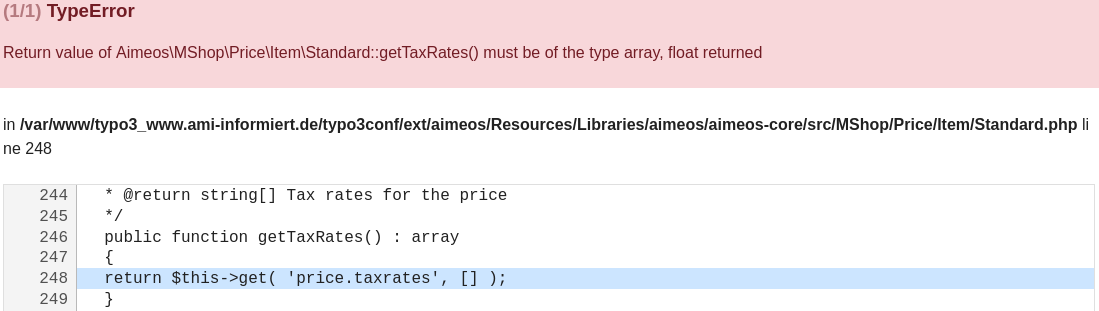

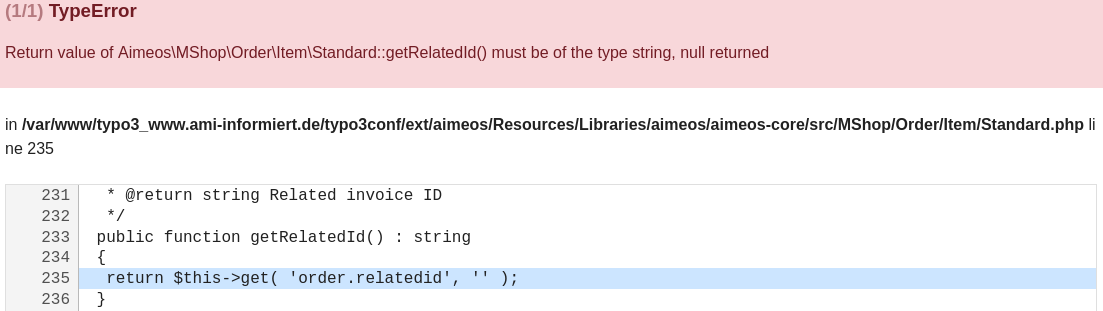

When I click on the order overview tab I get this error.
Also when I want to edit a product I get an error.

Post by aimeos » 15 Sep 2022, 10:22
There seems to be a problem in migrating the columns because mshop_order.relatedid must be VARCHAR NOT NULL and mshop_price.taxrates a JSON-encoded array of key/value pairs.

Post by aimeos » 15 Sep 2022, 10:28
Please check the columns in your database first. Afterwards, try to find out why the migration of the taxrates fails:
https://github.com/aimeos/aimeos-core/b ... axrate.php
