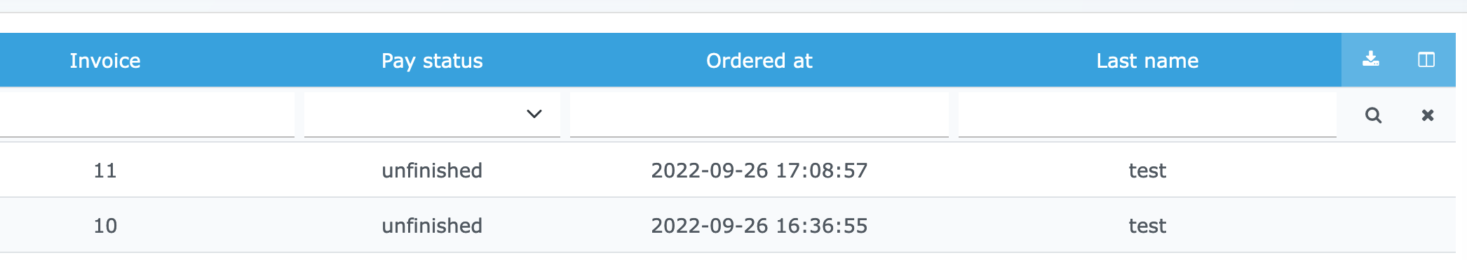

Post by tandT3 » 27 Sep 2022, 18:05
in our shop there is a payment method in advance. When a customer goes through the ordering process, the order is saved in aimeos, but the order status always appears as unfinished and no emails are sent. The status should actually be pending or authorized - right? What do we have to do? We're just a bit desperate about the settings...

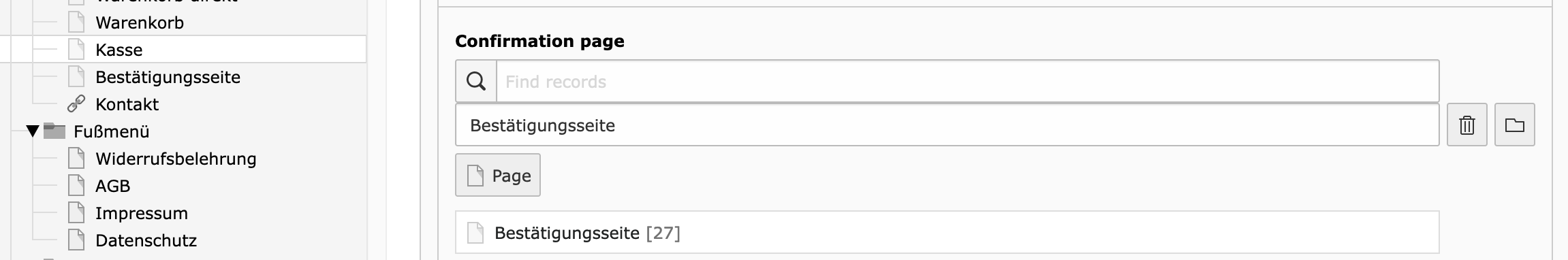

Post by tandT3 » 29 Sep 2022, 14:42
The confirmation page has been set and there is also a correct forwarding at the end of the ordering process.

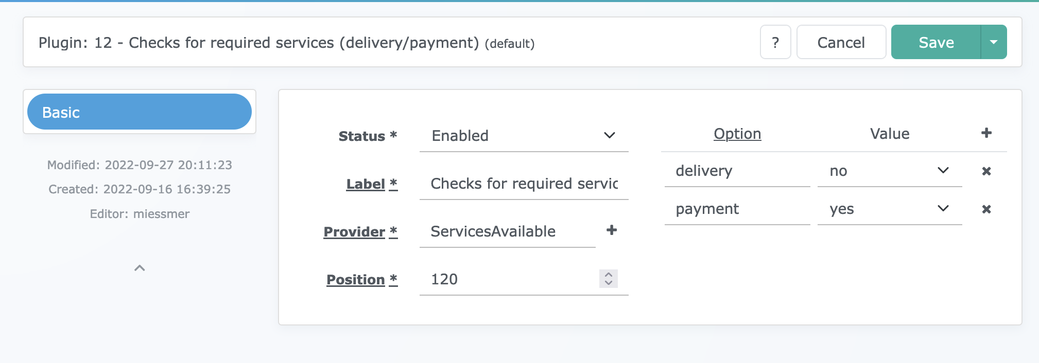

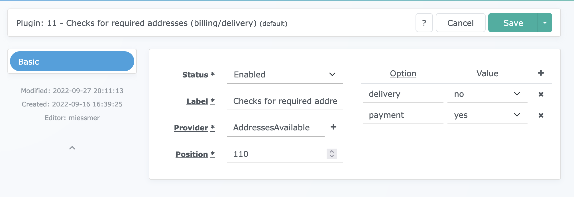

In the plugin settings for 'AddressesAvailable' and 'ServicesAvailable', we have delivery set to 0, since we don't have any shipping. In the typoscript we have accordingly:
plugin.tx_aimeos.settings.client.html.checkout.subparts {
0 = address
1 = payments
2 = summary
3 = processes
Could that be the reason?

Posts: 8746
Re: Pay status unfinished
Post by aimeos » 29 Sep 2022, 15:46
That's no problem as long as the payment service is part of the order (can you check?)

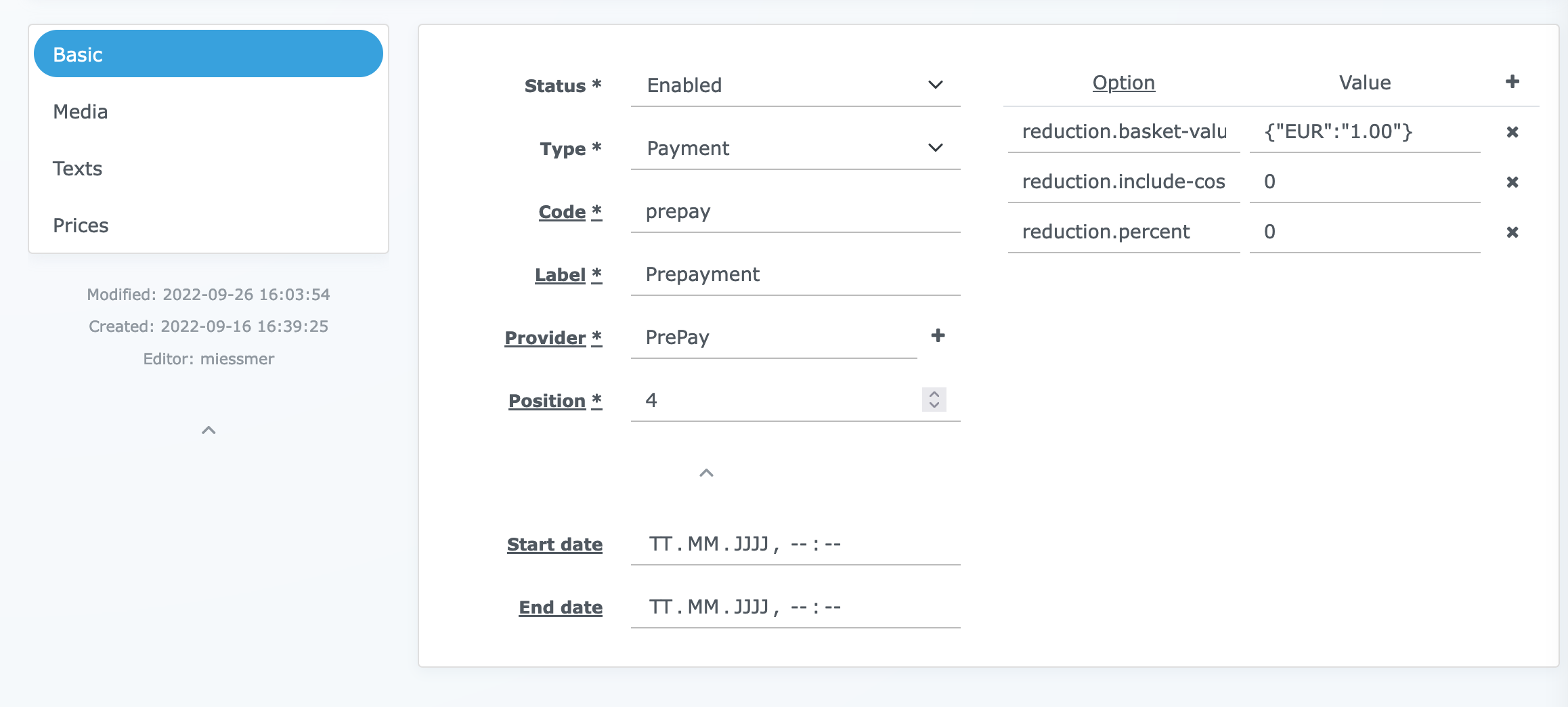

Post by tandT3 » 29 Sep 2022, 16:14
The selection of the payment method appears in the ordering process. Currently it is only pre payment, I can select this and go through the entire ordering process. Or do you mean something else with "payment service"?
Posts: 8746
Post by aimeos » 03 Oct 2022, 07:03
I meant in the order panel of the admin backend.
