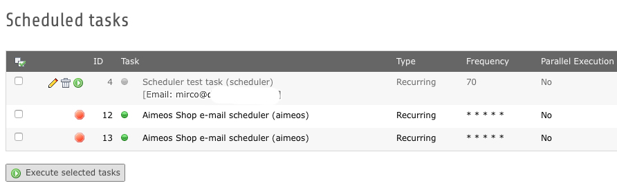

I have some trouble with the Scheduler Task:
[scheduler]: Task is already running and multiple executions are not allowed, skipping! Class: Aimeos\Aimeos\Scheduler\Task\Email6,
My E-Mail test task runs perfect but all aimeos tasks a running endless.
The permission for the aimeos Scheduler(incl. all files) folder is 775.
The typo3 version 6.2.12 and aimeos 2.3.0. PHP CGI 5.5
The installation runs on a shared web hosting server.
I call any 60 sec with a cron job following file:
I really appreciate any help you can provide.
Regards Mirco

- Schedul_Task_1.jpg (66.74 KiB) Viewed 29595 times

Are there any error messages in the madmin_log table or in the error log of the web server?Mirco wrote: My E-Mail test task runs perfect but all aimeos tasks a running endless.
I call any 60 sec with a cron job following file:Code: Select all
<?php exec("php /www/htdocs/w00de0a9/niederrhein-edition/typo3/cli_dispatch.phpsh scheduler",$ausgabe); echo "<pre>"; print_r($ausgabe); echo "</pre>"; ?>
As you are running your cronjobs via Apache, maybe they get killed after 30sec automaticaly due to the PHP max_execution time setting.

I have one more thing.
The manual start of the task in the typo3 scheduler works in aimeos version 2.3.0 without any problem,
Re: Scheduler: Task is already running and multiple executio
Hm, that makes it more difficult to find the root cause ...Mirco wrote:The manual start of the task in the typo3 scheduler works in aimeos version 2.3.0 without any problem,
Can you update to the version released today (2.3.1) and try again?
Locally, it works fine in our test installation - either executing the scheduler task via the TYPO3 backend, via command line or via your posted script.
