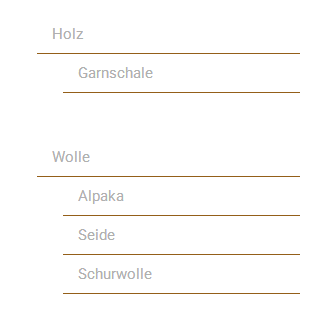

I defined several categories (pix_1)
and added two catalog filters in list view. One filter starts with 'Holz' the other with 'Wolle' (pix_2)

trimble wrote: I defined several categories and added two catalog filters in list view. With only one catalog filter there are no problems.
Interesting combination. I think nobody tried adding the categories filter twice yet.
What you do want to achieve? Maybe there's a simpler solution.

I want to place different parts of the categories at different places on the same website.

trimble wrote: I want to place different parts of the categories at different places on the same website.
Hm, that doesn't work at the moment because there's the exception thrown you've mentioned.
We will see how we can change that.
