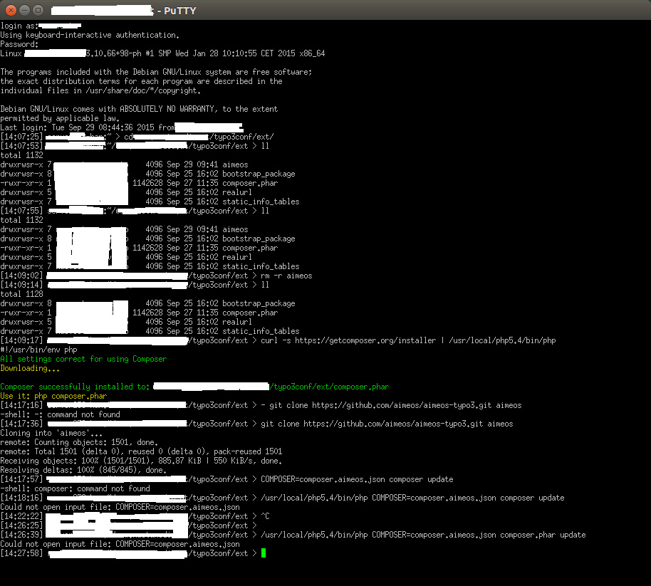

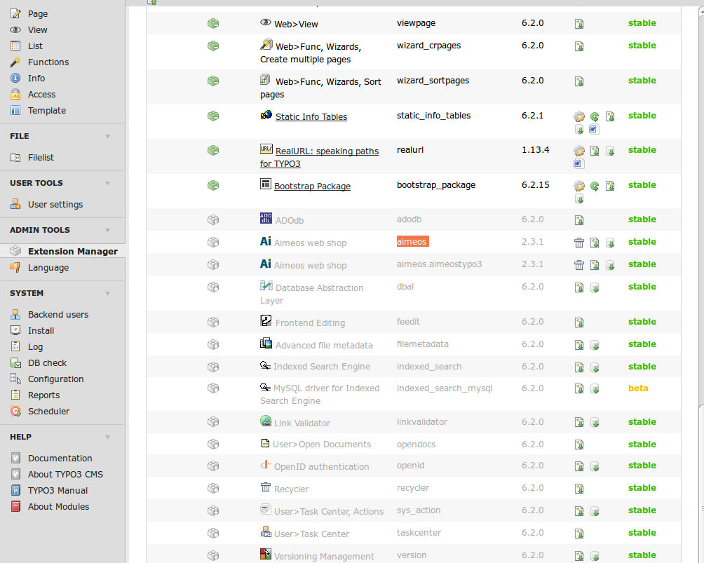

Now i tried to update aimeos and something is going wrong, and a little confused to me.
The Aimeos Extension is in a fresh installed typo3 6.2.15 and aimeos 2.3.1 from Extension Manger (aimeos is deactivated)
1. I logged in with ssh to my webspace and changed to folder typo3conf/ext/aimeos .
2. In "typo3conf/ext/aimeos" download composer with this command:
3. next run this command to do the updates:
Because the expected command in the documentation dont work for me.? Also Until i renamed the composer.aimeos.json to composer.json
4. activated aimeos in Extension Manager and updated Tables with green circle arrow
Next i tried to make the Scheduler Tasks but there is only a grey background without the necessary possibilitys to generate any tasks. The Frontend of the Shop is working. A look in the Extension Manager shows now 2 Aimeos extensions.?
what next? may you help me please?

thank you for answers!
curl -s https://getcomposer.org/installer | /usr/local/php5.4/bin/phpCode: Select all
/usr/local/php5.4/bin/php composer.phar update composer.json4. activated aimeos in Extension Manager and updated Tables with green circle arrow
Thank you?
- ssh-aimeos-update.jpg (135.29 KiB) Viewed 36607 times
- extension-manager-aimeos-update.jpg (120.72 KiB) Viewed 36607 times
Re: Scheduler error
You need to use exactly the command as described in the documentation (https://aimeos.org/docs/TYPO3/Download_ ... test_code) to get it working in "./typo3conf/ext/" (not "./ext/aimeos"!):
- php -r "readfile('https://getcomposer.org/installer');" | php -- --filename=composer
- git clone https://github.com/aimeos/aimeos-typo3.git aimeos
- COMPOSER=composer.aimeos.json composer update
There must be no already installed Aimeos extension in your TYPO3 instance before.

Re: Scheduler error
hm ok,
with SSH-client (PuTTy) i can't execute exactly the described commands.
i tried once without success. Please have a look at the jpg.
with the command in ./typo3conf/ext/:
"COMPOSER=composer.aimeos.json composer update"
i get this back:
"- shell: composer: command not found"
sorry, but i need further help.
Thank you!
i get this back:
Thank you!
- ssh-aimeos.jpg (203.56 KiB) Viewed 36587 times
