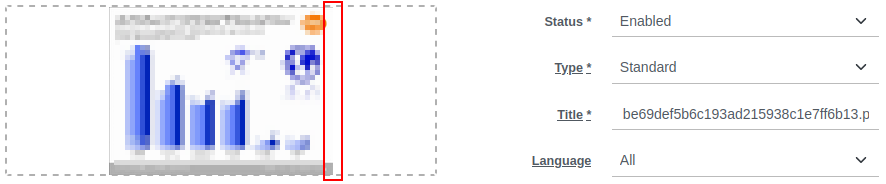

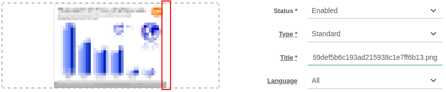

Post by Moritz » 16 Jan 2023, 13:50
I have re-uploaded and saved the image of an old product.
When converting to WebP, a piece of the right edge was cut off.
My settings are as follows.

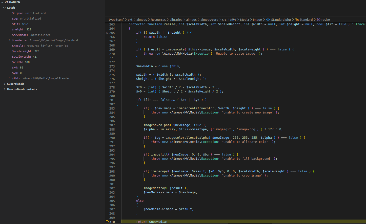

Post by aimeos » 18 Jan 2023, 10:20
Can you check in the resize() method if there's something wrong?
https://github.com/aimeos/aimeos-core/b ... #L229-L249

Post by Moritz » 18 Jan 2023, 11:28
The function is not executed in my case.

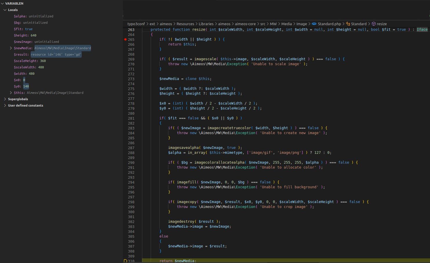

Re: Image Format WebP
Post by aimeos » 19 Jan 2023, 13:56
Moritz
Posts: 158
Joined: 07 Nov 2018, 14:05
Post by Moritz » 20 Jan 2023, 09:48
Yes, the method is executed twice.
PHP 8.2.24
Typo3 v12.4.23 LTS
Aimeos web shop 24.10.2
Post by aimeos » 20 Jan 2023, 16:26
Didn't know that GD supports WebP now.
You can either install the PHP Imagick extension or check in the resize() method if there's something that removes the border.
