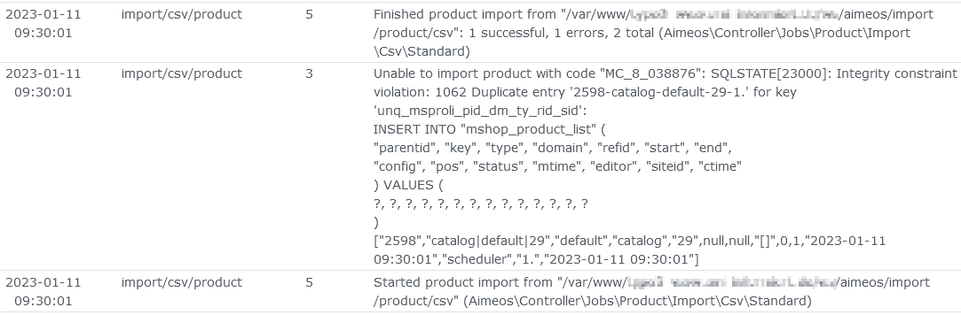

When I want to update an existing product via the CSV import I get the following error.

Seems like you've added a category twice to a product

The product in my screenshot with code "MC_8_038876" already exists.
Is it then correct that the category is inserted again in mshop_product_list via INSERT?

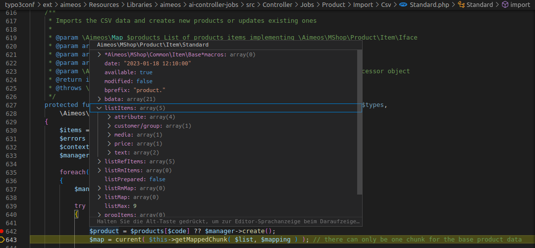

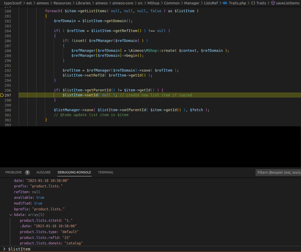

I've debugged the import.
Here is the $listItem that throws the exception.
The ID is set to null.
In the next line when you call $listManager->save() the Exception occurs.

Post by aimeos » 18 Jan 2023, 10:31
The root cause of the problem is probably in these lines because a new list item seems to be created instead of the existing one reused:
https://github.com/aimeos/ai-controller ... #L136-L137
Please check if the product item fetched from the database contains list items for the catalog relations at all.
