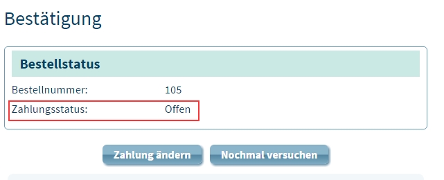

1. If i start an order in the shoping cart (in testmode), confirm it on payment provider´s site and on redirect back to my website´s shoping cart, the order is not confirmed here, too. Any idea why not?
Status is always open with mollie
2015-11-20 09_52_09-aimeos.jpg (49.94 KiB) Viewed 10827 times

abv wrote: 1. If i start an order in the shoping cart (in testmode), confirm it on payment provider´s site and on redirect back to my website´s shoping cart, the order is not confirmed here, too. Any idea why not?
What payment method do you used? Bank transfer for example won't update the status immediately.
