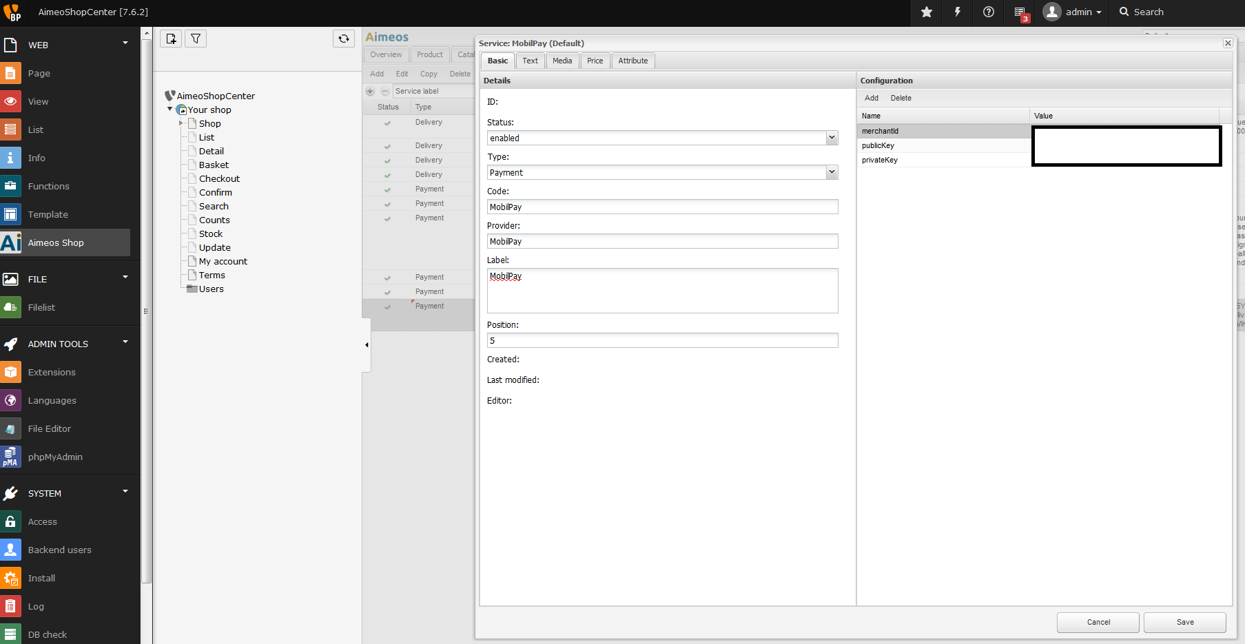

with the following code and settings in admin panel(merchantid, publickey, privatekey) it gives me a message (frontend):
Order status
Order ID 18
Payment status unfinished
and stays on page, not trying to connect to Mobilpay.
I've tried even with Omnipay settings but it's not working neither.

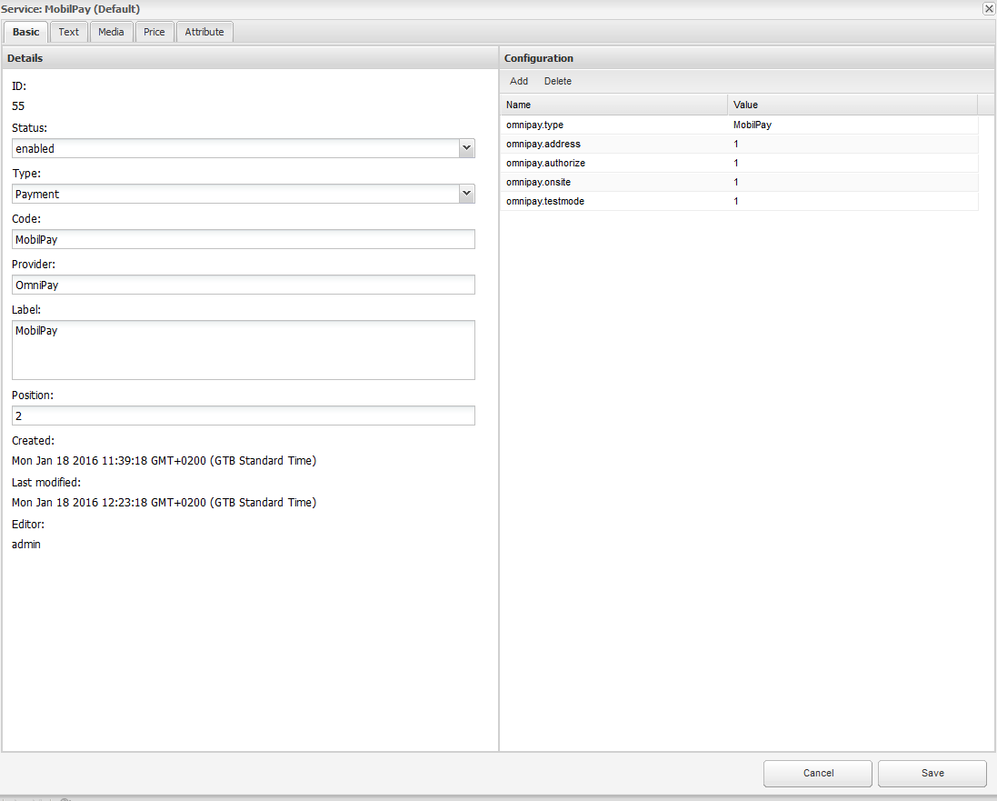

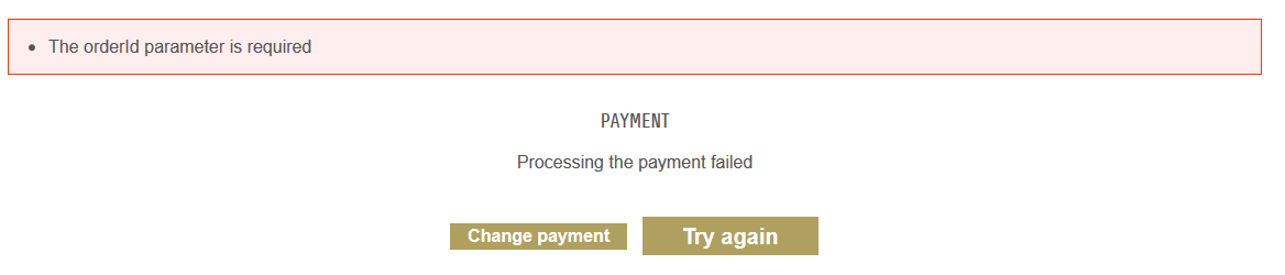

i've changed the settings to the following variation and it passed through, it asked me for a card number and cvv(i set it up a virtual one for test) now it gives me the next error message:

Post by aimeos » 18 Jan 2016, 14:22
Please tell us first how MobilPay works. This is important for what have to be done.
The output you get is due to the "omnipay.onsite" parameter you've set but it's not necessarily correct.
