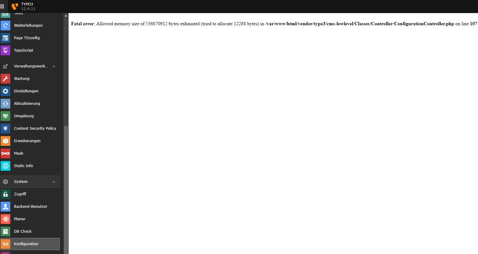

Hi Aimeos-Team,
the typo3 (version 12.4.11) backend module configuration (https://docs.typo3.org/m/typo3/referenc ... Index.html) gets a HTTP-500, memory-limit exceeded. Even if I change the limit from 512MB to 16G.
All other backend pages and frontend seems to work for 512MB.
Thank you!
Ralf
Thank you!
Ralf

Re: Aimeos 23.7: memory-limit exceeded in Typo3-Backend-Module configuration
No, the configuration module of typo3.
If I uninstall the aimeos-extension, it works again.
- screenshot-2024.03.07-14_19_29.png (63.08 KiB) Viewed 163613 times

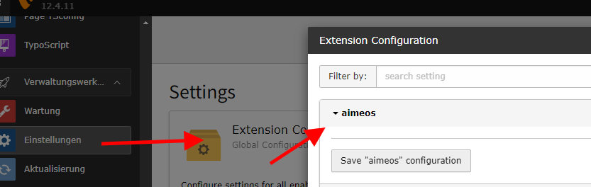

That dont work, this file is for "Einstellungen -> Configure extensions -> aimeos" and now that is empty as you can see but has no affect on the "Konfiguration" module.
In the configuration module are $GLOBALS-vars, Middlewares, Events etc. of the whole typo3 system.
