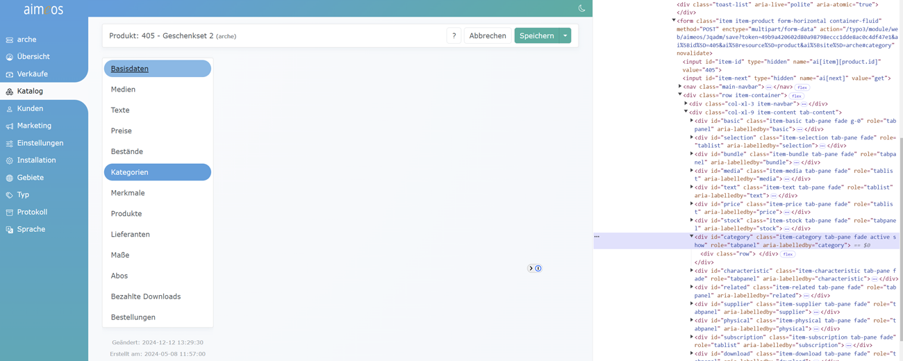

Post by promptnet » 12 Dec 2024, 12:39
Hm, under "Product" > "Categories" there is just a blank area. No categories to select.
And there is no error in console.
Under "Catalog" > "Categories" there are all categories.

Post by aimeos » 12 Dec 2024, 12:58
Can you post a screenshot of the product categories sub-panel?

Post by aimeos » 12 Dec 2024, 13:21
Looks like a JS error, maybe due to invalid escaping of an output. That should be visible in the browser console
