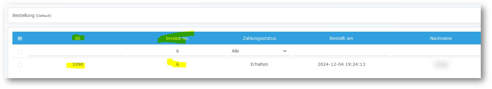

after the upgrade to 2024 the order email has the invoice no set in the email subject.
For easier handling we still need the order id instead.
How or where can that be set.

Re: Order ID in email subject instead of invoice no
Unfortunately, the simple solution doesn't work for the future but only for the current (or past) order.
If a user breaks up during the checkout, only the order number is incremented but not the invoice number. That's why we now have the same problem again.
