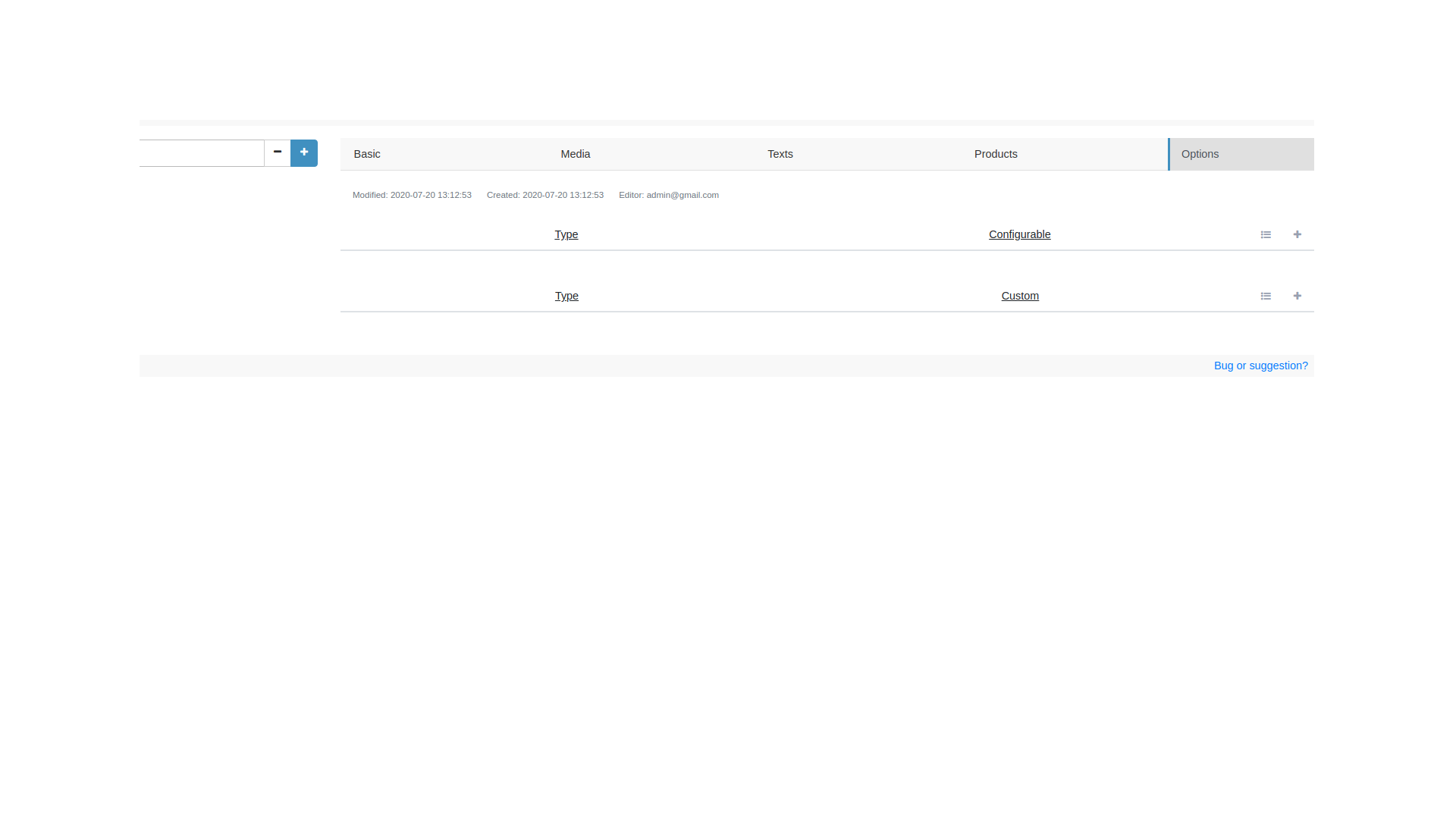

Post by Oleh » 20 Jul 2020, 13:56
I added options in catalog like this is in products.
I resolved all errors and saved options to mshop_catalog_list with domain attribute.
Then I need to show all options related to catelog in options subpart.
How I can do this, I try to debug code in Catalog/Standart.php, but cannot find something.
I attached file where I want to show attributes related to catalog.
Thank you
Re: Relate attribute to catalog
Post by aimeos » 22 Jul 2020, 07:37
Use the code in the product characteristics panel as reference for saving the attribute references:
https://github.com/aimeos/ai-admin-jqad ... acteristic
