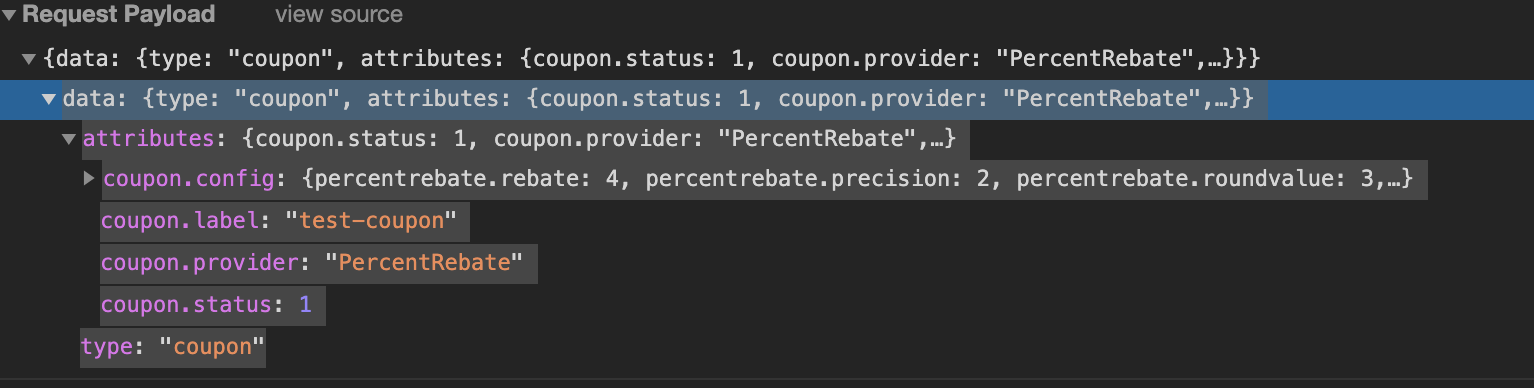

I am trying to create a coupon with configs and decorators by using JSON API Admin,
this is the request data which I call the API
inside the coupon.config I use the object with decorators key and value
Screen Shot 2020-08-16 at 5.34.06 PM.png (94.92 KiB) Viewed 4763 times

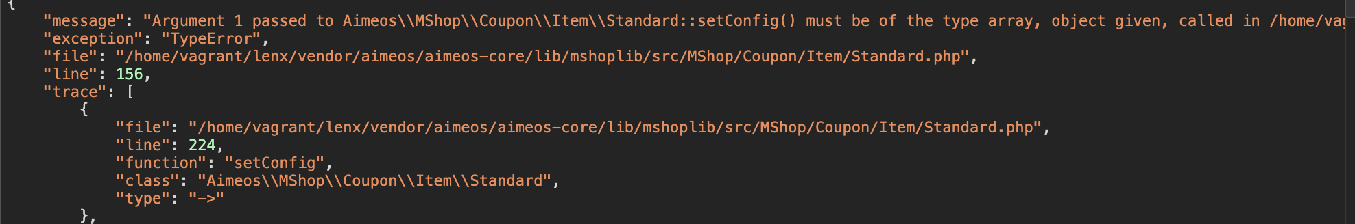

and this is the response I received. As I understand the requirement is coupon.config is an array
Screen Shot 2020-08-16 at 5.34.33 PM.png (102.14 KiB) Viewed 4763 times
The problem is: when I call using the array, such as
coupon.config : [{key, val},{key, val}]
The JSON API will accepted and store the array
However, the backend wont work and keep it the same
{0: [{key, val},{key, val}]}
While using the JQADM the result in database is an object and everything will be fine
{key: value},
{key:value}
