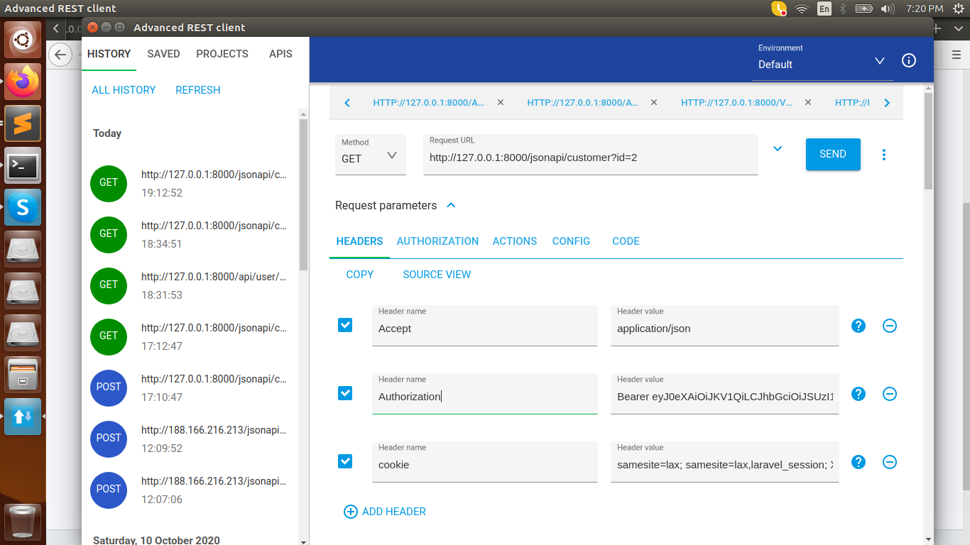

But when I am trying to fetch Customer Detail and passsing Authorization Header as 'Bearer XXXXXXX' (Access Token) . Not getting the details.
What am I doing wrong.
Screenshot from 2020-10-18 19-20-41.png (196.71 KiB) Viewed 1643 times

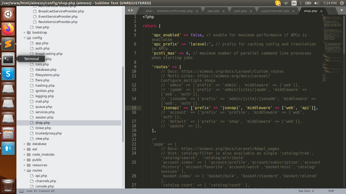

Apart from that I changed the shop.php configuration file also
Screenshot from 2020-10-18 19-24-31.png (252 KiB) Viewed 1643 times

Hard to say from an outside perspective. If
Auth::id()
returns the ID of the user record, Aimeos should return the customer data via the JSON REST API too.
