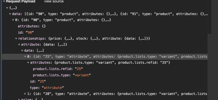

- I am using JSON API to create a variant article with existing attributes to include to Selection product
below Image is the data in the request.
- The problem is after submitting, the product.list.type = variant is automatically change to 'default'
I am currently using Aimeos laravel ver 2020.10*
- Screen Shot 2020-12-03 at 4.05.17 PM.png (61.46 KiB) Viewed 11439 times

Can you please post your full request and response including the code for building the request?
Re: JSON API - create new product and add existing Attributes with Product.lists.type
this is the data in the POST request

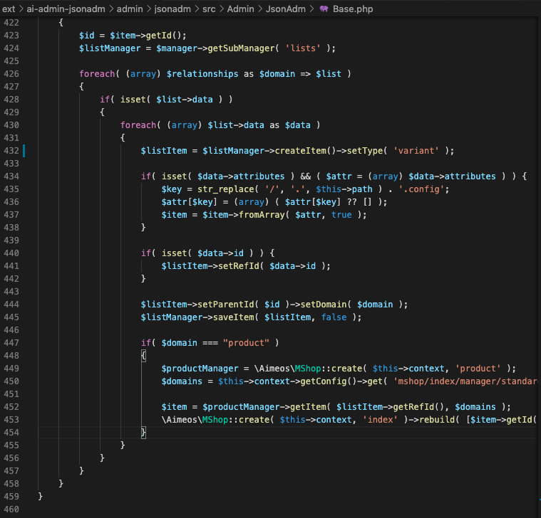

when I check the source code in JSON ADM
As the line 432 the source code
$listItem = $listManager->createItem()->setType( 'default' );
I change to 'default' to 'variant' the variant is set for the product.lists.type
How could I extend the source here to get the product.lists.type from the request
In line 437 (fromArray()), your product.lists.type should be set to "variant" if you pass that via the JsonAdm API. Can you please check what does happen there in your case?
Thank you for your response,
However the product.lists.type is still "default"
could you please call an sample API fo checking it?
- create a new product with existing attributes and the product.lists.type: "variant"
as I am checking the In line 437 (fromArray()),
the $item is the product id rather than the product.list
I changed to this one and the product.lists is saved as expected:
would you like to check the source is it alright or any problems with my change?
$item = $item->fromArray( $attr, true );
$listItem = $listItem->fromArray( $attr, true );
Yes, it should be $listItem instead of $item. Can you create a PR for your fix?
