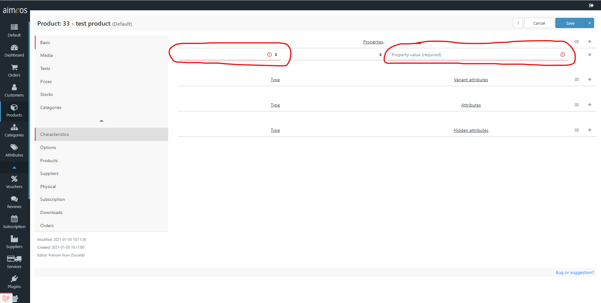

Hey, I was testing the Aimeos back office when I stumbled upon this error, do you have any idea why?
I tried this very same process on your demo and everything works as expected, I don't know what I did wrong.
Link to view how I got this error: https://www.loom.com/share/ca1262a318c4 ... a3cf0b70cb
Thank you!

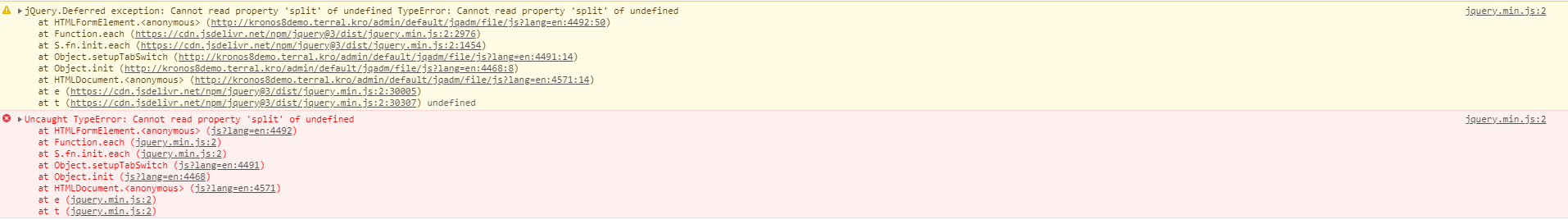

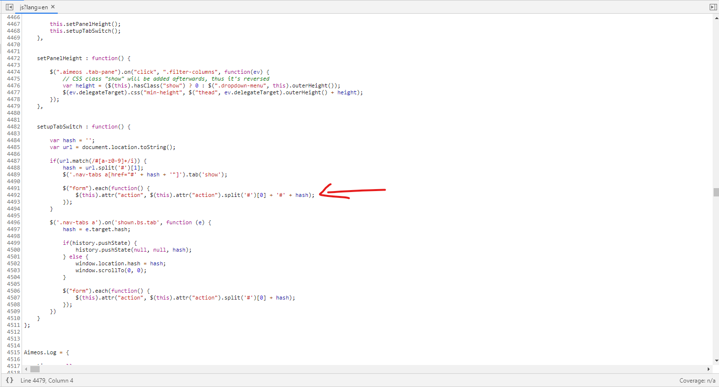

Here are some screenshots showing the issue with more details.
Source code of error
fichier js.png (81.22 KiB) Viewed 8611 times
Console error
Console error

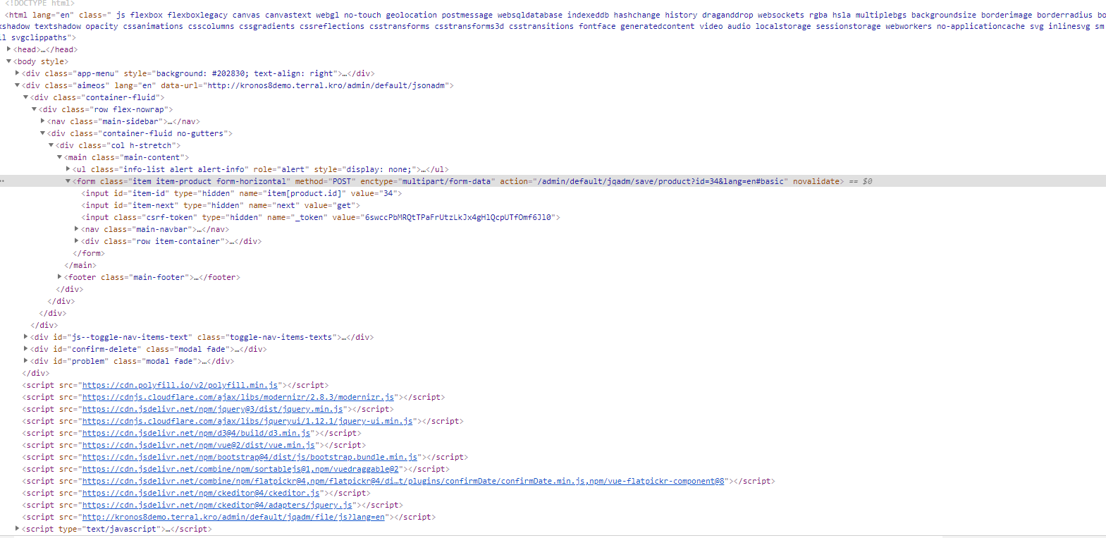

The error in your screenshot is related to the tab switch between "basic" and "characteristics". Can you please post the main <form> tag including it's full "action" attribute?
svedrine
Posts: 6
Joined: 04 Jan 2021, 13:26
Re: Error on save after clicking on characteristics without adding one
Post by svedrine » 05 Jan 2021, 11:02
Here it is.

Everything looks fine. Can you set a breakpoint in your browser console and check the value of
$(this).attr('action')
in line 4492? Maybe it's another form that's causing the error.
svedrine
Posts: 6
Post by svedrine » 06 Jan 2021, 11:30
It returns 'undefined'.
