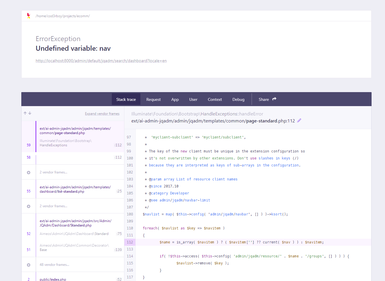

I recently upgraded my aimeos-laravel version from 2020.10 to 2021.04.
I followed the upgrade guide here https://aimeos.org/docs/latest/laravel/setup/#upgrade and made changes to my custom extension according to this change log https://aimeos.org/docs/latest/changelog/2021.x.
After the upgrade, everything is working fine (my custom jsonapi, custom domain managers for new domains, etc.) except the admin panel.
Whenever i log in to the admin panel, i get the following error -
Screenshot 2021-05-31 144948.png (105.07 KiB) Viewed 1830 times
After removing my custom extension from project, I do not get this error and admin panel works fine. So I think my custom extension is causing the problem.
I have already made required changes to the source code of my extension and i don't know the reason behind this error therefore i need some help.

So at last i finally found the exact location of the error.
The configuration admin/jqadmin/navbar in my custom extension was the source of error. Once i commented the navbar configuration code the admin panel started working properly.
But now my custom jqadm panel items are missing in the admin navbar.
I think navbar configuration value of aimeos-laravel 2020.10 is not compatible with aimeos-laravel 2021.04.
How can i properly set navbar configuration in aimeos-laravel 2021.04?

Found proper configuration of navbar here https://github.com/aimeos/ai-admin-jqad ... navbar.php
Anyway Thanks.
