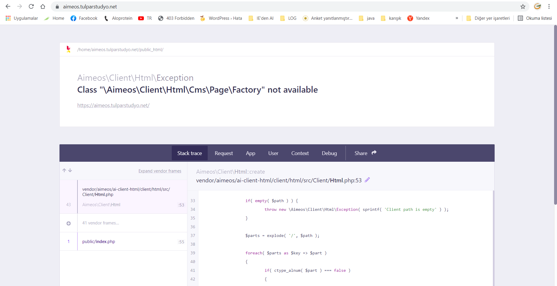

I created new extension for version 2021.07.3. I Copied default template files from /vendor/aimeos/ai-client-html/client/html/templates to /ext/sw-panel/client/html/templates . After I visited my site home page.
How can I fix this error "Class "\Aimeos\Client\Html\Cms\Page\Factory" not available".
- aimeos-error.png (85.69 KiB) Viewed 7830 times

If you don't have aimeos/ai-cms-grapesjs package installed, remove "cms/page" from "catalog-home" in the "pages" section of your ./config/shop.php

I installed composer require aimeos/ai-cms-grapesjs, The proplem is solved.
