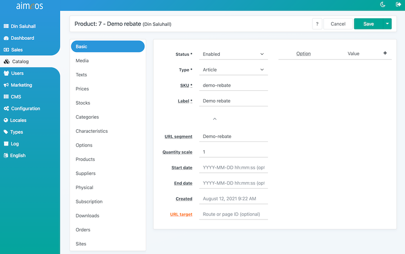

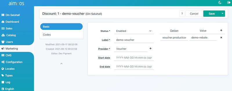

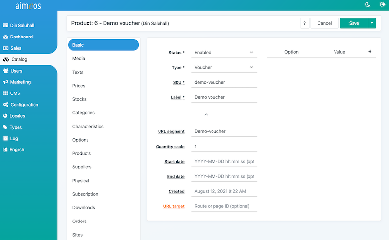

Yes, I've read that, multiple times. Doesn't really help me to understand this issue.aimeos wrote: ↑17 Sep 2021, 19:14 Can you post screenshots of your voucher configuration and the configured voucher product from the admin backend?
-> AttachedYou have deleted the voucher product from the demo setup and you need to create a new one now which you can refer to in your voucher configuration.
-> No, not exactly.
At first, I created a new type voucher under Marketing->Vouchers and deactivated the demo-one.
When I created a new voucher-product, and purchased that one, the codes was generated with a reference-id to the original, disabled demo-voucher.
Then I reenabled the demo voucher and deleted the one I created, and tried with the original demo-voucher.
Now I can purchase a demo voucher, then add the voucher code from that one in a purchase, but I'm getting the error "No item found for conditions: Array ( [product.code] => demo-rebate )" for the original demo-voucher. So it's the original demo-voucher that does not work. The one I created did not work either, but with a completely different error.
