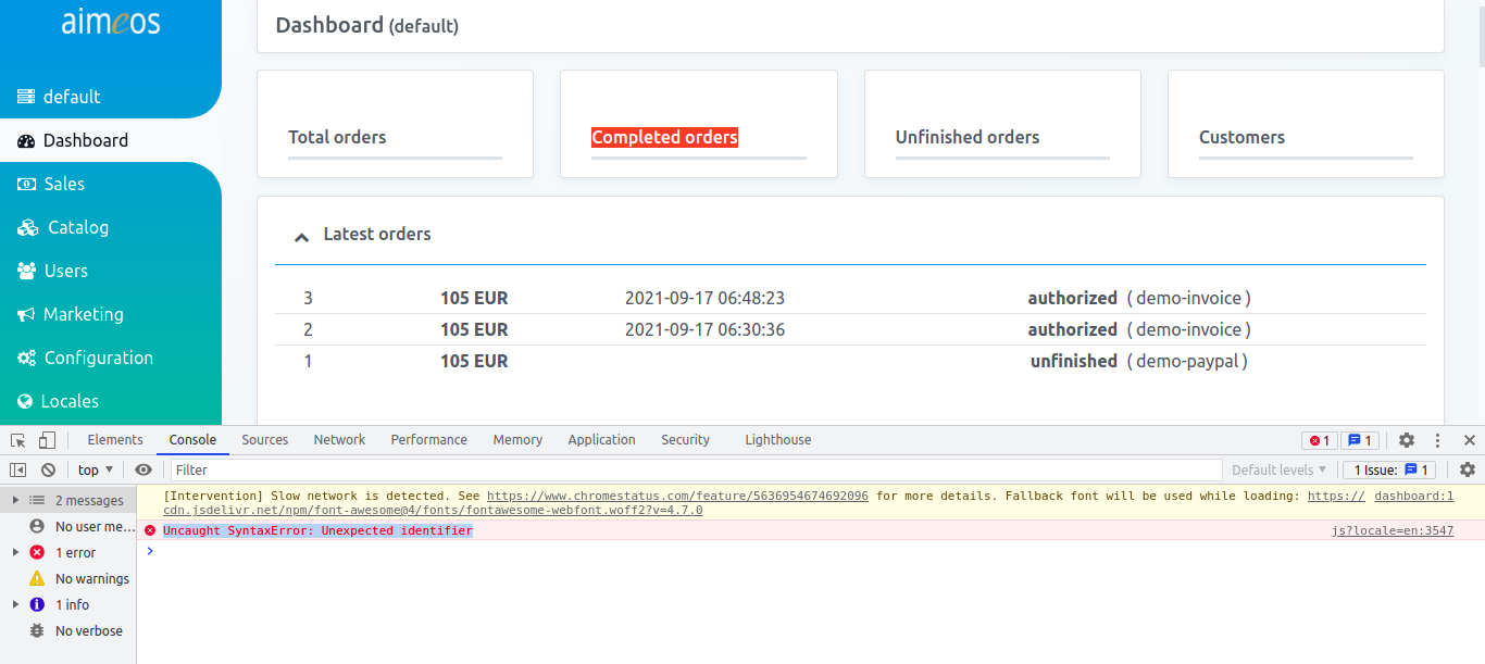

I am also started to get this error in my admin panel and no tab works, i can not open the catlog or anything else, only the dashboard page and logs page is being open but that also does not work propely
- Now i started to get this error on my admin panel
- Screenshot from 2021-10-08 01-02-50.png (128.37 KiB) Viewed 6316 times
Re: Checkout Process - Error on Summary Tab
Can you post a screenshot after you've clicked on the "js?locale=en:3547" link right of the error message?
