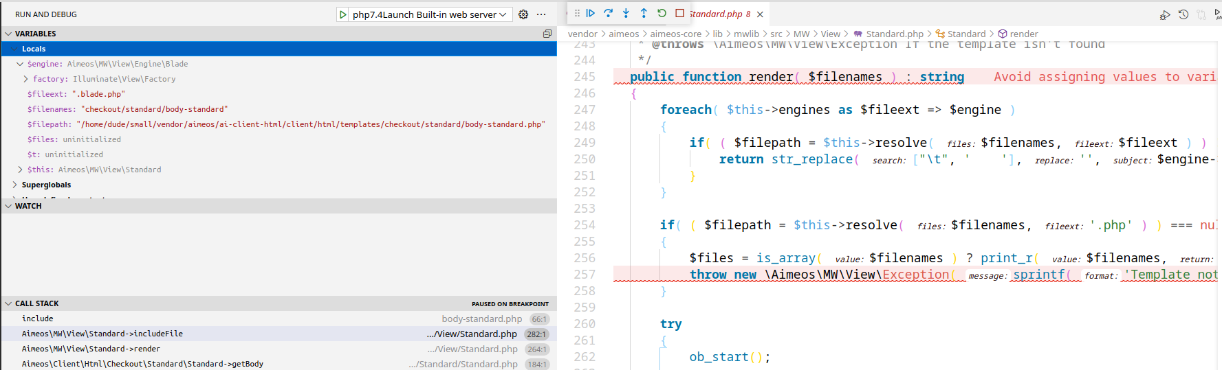

I think it blows up here. looking for a file body-standard.blade.php that does not exist.
I am not sure if I should provide that file or that file should not be called for.
Regards,
Regards,
- body-standard.blade.php-missing.png (161.3 KiB) Viewed 5669 times
Re: Payment Gateway WechatPay
The view implementation tests if there's a body-standard.blade.php file available and prefers it over a body-standard.php but that should be not a problem and is also not related to your initially posted error message.

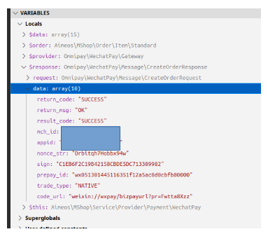

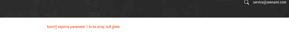

I am able to make some progress, got SUCCESS response from WechatPay gateway (see attached imageJ).
But it still gave error at the end>
- enderror.png (14.34 KiB) Viewed 5535 times

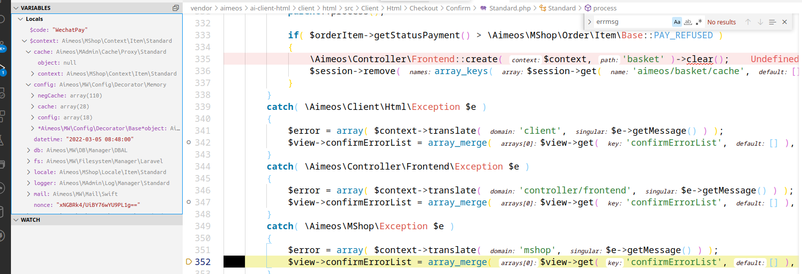

It seems complaining the frontend::create first parameter '$context' has cache to be null.
Regards,
Regards,
- contextcachenull.png (215.68 KiB) Viewed 5534 times
