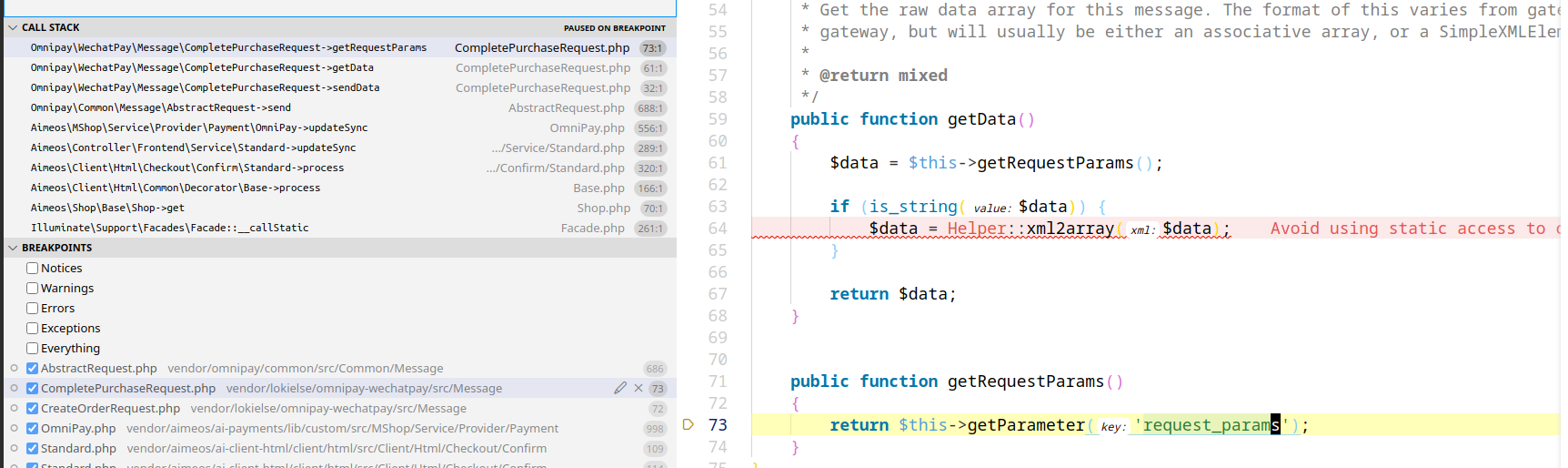

That's not the problem. You have to find the ksort() call that recevies a NULL value instead of an array.

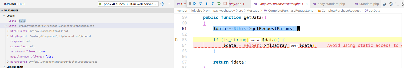

the Omnipay\WechatPay::getData was called and null return passed to ksort routine. (see attached call stack).
I am not sure if this version of getData is the right one to call.

$data = $this->getRequestParams(); returns null, which is the input $data for Helper::xml2array(), then also returning null.
regards,

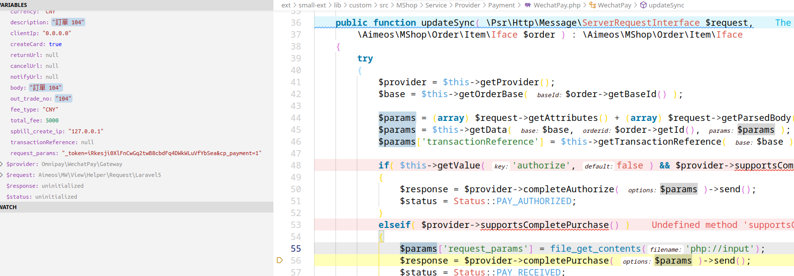

I have over-ridden the Omnipay::updateSync method, and added one line to obtain 'request_params'. but it complained xml2array failure.
Please enlighten.
Regards,
