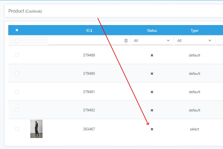

Re: How to automatically disable "select" product with disabled variants ("default")?
Thank you for the answer.
I was referring to setting the Status of the "select" product to "Disabled". For "default" products it happens automatically, if the stock level is 0.
In this case (please see attached picture), the whole product can be disabled, and I was looking for an automated process.
When the "select" product is disabled, it no longer shows on the Category page, which is the expected outcome, so disabling the "add to basket" button is no longer needed.
So to rephrase my question - is such automated mechanism of disabling "select" type products when all of it "default" type products are disabled, implemented in Aimeos?

- aimeosQuestion2.jpg (50.83 KiB) Viewed 2372 times
The status for products of type "default" is not set to "disabled" automatically if their stock level reaches 0. If that's the case, it's a custom implementation in your setup.
