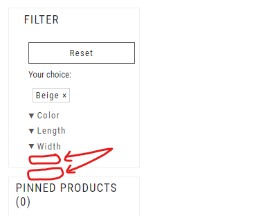

Hello again,
How aimeos hide the unmatched attribute in the searching filter page?
- Screenshot 2022-06-29 125458.png (11.48 KiB) Viewed 2087 times
Re: unmatched attribute in the searching filter page
It uses Javascript to hide the attributes without counts:
https://github.com/aimeos/ai-client-htm ... hp#L13-L21
