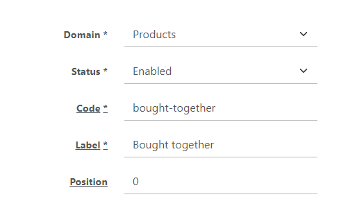

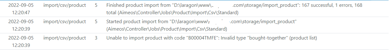

Laravel version 9.22.1 , Aimeos version 2022.07.2 and PHP version 8.1.3 (Win)
i am using bought-together in product lists type in csv but it is showing invalid type

The list type for products bought together is not allowed to be imported by default because this product relations are generated by the product/bought job controller:
https://github.com/aimeos/ai-controller ... andard.php
To allow this list type, you have to add it to this configuration in your ./config/shop.php:
https://github.com/aimeos/ai-controller ... hp#L51-L77
