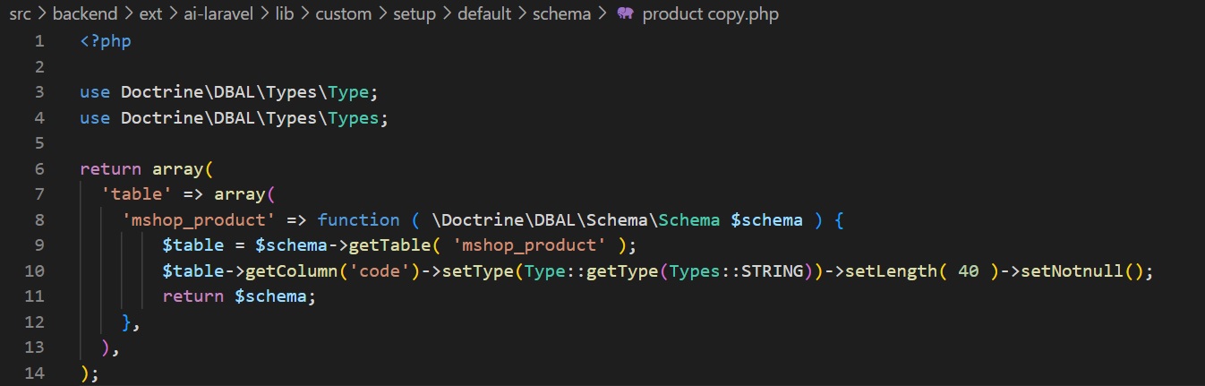

Yeah.. how I wish we could easily change as easy as that. It is already in production in a dockerized server.
I wonder where to change the migration of the aimoes or a refence how to reconfigure the default product table?
I hava tried to do this without error but only the length and not null only reflected. The change type to string does not work. Any idea why?
set type.jpg (89.72 KiB) Viewed 5263 times
$table->getColumn('code')->setType(Type::getType(Types::STRING))->setLength( 40 )->setNotnull();
reference: https://aimeos.org/docs/2021.x/infrastr ... ing-tables
Re: Make filter in back-end not case sensitive ?
Post by aimeos » 08 Sep 2022, 09:15
Have you tried changeColumn() like written in the referred docs?
$table->changeColumn(  'value', ['length' => 64, 'customSchemaOptions' => ['charset' => 'utf8mb4', 'collation' => 'utf8mb4_general_ci'] );
